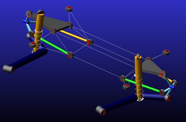

Hi, I would like to create five link non-steerable suspension for the rear axle. I'm not sure how to deactivate/switch tie rod to trailing arm. Could anyone please help me how to do this? Thanks in advance!

    You can use the multi-link.tpl template already available in the acar_concept database for starters.
    This one has a trailing arm already built into it as seen from the image.
    If you would like to use the subsystem directly, then you will find it as rear_multi_link_susp.sub under the same acar_concept database.
    rear_multi_link
    Hope this helps!

    what suspension are you using, is that from one of the available databases? e.g: in <acar_concept> database there is a 'Double Wishbone Advanced Suspension' which brings a variety of configurations.
    Adams Car Package > Adams Car > Working with Templates > acar_concept database

    Hi PJ,
    From the multi-link.tpl can you make the upper control arm into two separate links? I am trying to model a suspension with 5 separate links.

    I've tried using 'Double Wishbone Advanced Suspension' template but wasn't able to find any option to switch the tie rod to fixed linkage. If you have any suggestions, please let me know!

    As far as I know, if you don't have a steering rack, the tierod will be connected to the chassis via joint or bushing.
