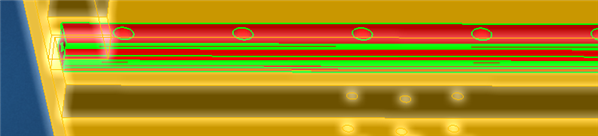

I want to model a rail as a flexbody in ADAMS. However to do this I need to create rbe2 on the top surface of the rail shown in red and create a translational joint between the rail and another part. This will make the rail rigid.
How would you approach to this problem?

    Hi Koray,
    Could you explain why you need to create RBE2 elements on the whole top surface?
    Thanks,
    Maziar
  • Koray
    0 Koray over 9 years ago
    For creating an interface node to use in ADAMS. I cant use rbe3's for mnf generation, can I.?
  • Maziar R
    0 Maziar R over 9 years ago
    I think I did not pose my question properly. What I am trying to ask is:
    Why do you need to create the rbe2 elements on the "whole" top surface? Why do you not create the rbe2 elements at, for example, where you have connections?
    I hope I am clearer now.
    Thanks,
    Maziar
  • Jesper Slattengren
    0 Jesper Slattengren over 9 years ago
    Yes, you can use RBE3 elements.
  • Koray
    I will have a connection (translational joint) on the whole top surface.
