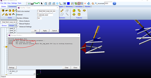

Error in doing flex of lower control arm using Viewflex in Aview, failed in mnf creation
Sudeep Tyagi
Sudeep Tyagi over 7 years ago
Now I have succeded with the Boolean function and able to combine the bodies.Next I want to flex the lca using Viewflex,I am getting this error mnf creation failed
flex error
I have used this as an input
Can anyone solve this

    Sundeep,
    You would need to go to the Advanced Settings to (a) properly generate a mesh and (b) select proper attachment points. When generating the attachment points, you would need to carefully create RBE2 elements to connect the attachment marker (master node) to the slave nodes on surfaces, edges, or similar.
    If you need help with this and have access to our eLearning courses, I recommend that you go through the course ADM710 . For more details on ViewFlex, you can review section 11.

    Hey Maziar I am saying that mnf has failed because its showing the error(mnf creation failed) dialogue box when I hit the viewflex to generate mesh after providing this as an input.
    (missing image)
    (missing image)
    This is the answer of your first part how I can say that mnf creation failed and ViewFlex has failed to create the flexible body part
    Talking about the lisence part I am doing this flex analysis in Adams view which is endorsed with lisence,I have adams flex licence too but its no way related as I am doing this flex in Aview itself
    Now I am attaching fo6 file
    Pls solve this issue as immediate as possible
    If you want I can provide u the database as well
