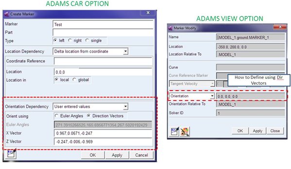

In ADAMS/CAR, Direction vectors can be used to define orientation. How do I use Direction vectors option in ADAMS/VIEW platform? Thank you
Thank you

    Hi Maziar,
    Thank you for the useful information.
    The reason for asking the question is, the direction vectors of the principal moment of Inertia plane are printed out by CAD software when inertia are calculated . I am trying to take advantage of that data. I have attached a photo of what I am looking for in ADAMS/VIEW.

  • MK202610123211
    0 MK202610123211 over 7 years ago

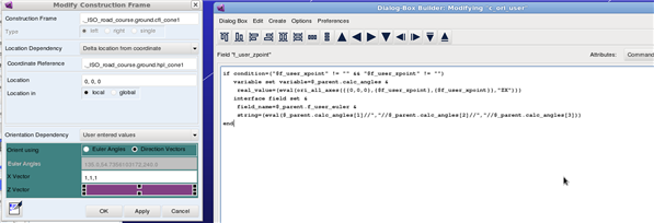

    First thing you have to know is that A/Car is nothing but a heavily customized A/View.
    Many things are done in the dBoxes and/or via functions.
    Usual way to find out is to check with the info button what the marker parametrics ended up with after modifying it with the dbox.
    In this case you'llfind that it just changed the euler angeles in orientation, which brings us to the trace that maybe the dbox is doing all the calculations.
    And bingo: It uses ori_all_axis to calculate new euler angles from the given input.
    direction_vectors
    How could you use that in A/View ?
    Well ori_all_axis is a design time function and could also be used as a parametric expression for orientation of markers like
    orientation = (ori_all_axis({{0,0,0},{0.9,0.06,-0.2},{-0.2,-0.006,-0.9}}, "ZX")
     You could also build an own dbox or enhance the existing one with the above algorithm.
  • ilapakurti Venkata Naga
    0 ilapakurti Venkata Naga over 7 years ago
    Thank you Martin.  Your answer was the solution, I was trying to  loo​k up.
