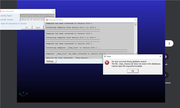

Hi, Im getting this error while trying to open my full vehicle assembly and ive no idea why. Front and rear suspension assemblies will open but not full vehicle. Thanks, Cillian

    The error says that the chassis template is missing. So that file is missing ...

    Hi Cillian,
    Please open body subsystem in any text editor and check path for "_fsae_chassis.tpl" template. Adams cannot find related template for body subsystem and issued an error. You could also have a look in template.tbl directory in database, if this template exists. It could by also "typo" problem, then check file name.
    Hope it helps.
    Krystian

    Error is fixed thanks Krystian :)
