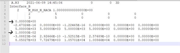

Hey all,
I was wondering if someone has made a python script to read out .req files, and is willing to share his code, before i start to reinvent the wheel.
Example of my req. file:
Timestep value start at row 6 and the request results are shown on row 7 and 8.
Knipsel
Thanks in Advance!

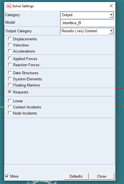

  • niels.devries
    0 niels.devries over 5 years ago
    @Martin Kieltsch​ Because of the file size. .res files are much larger compared to .req files. Atm i saved 1000+ sim results in .req format which is only ~1GB. Saving this in .res format would results in ~100+GB
  • niels.devries
    @Martin Kieltsch​  Ah i just found out you can actually select/deselect what you want to save in the .res file, which would results in the same file size, oops :P
    Anyway, i got my python scripts working with .req files now, but i keep this .res option in mind, thanks!
