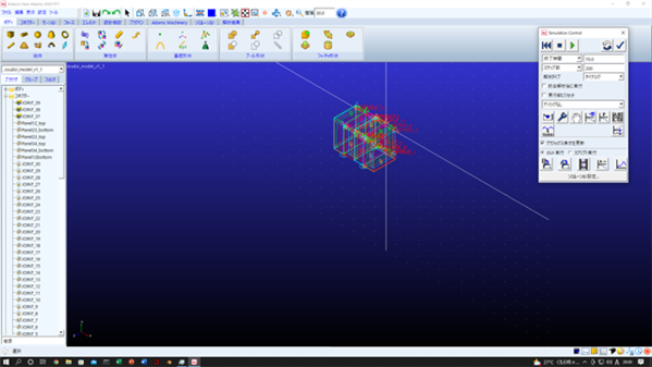

Interactive simulation of Adams is very slow. It takes about 2 minutes to simulate as shown in the picture.
Also, it uses only 10% of CPU and 2% of GPU.
Is it possible to use more memory, CPU and GPU for faster simulation?I would like to increase the memory, CPU and GPU utilization.
Is there any setting that can make it faster?

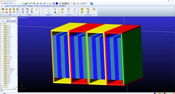

    Turn off interactive animation. It is also very hard to see what your model contains. Looks like a bunch of plates connected with very short beams?

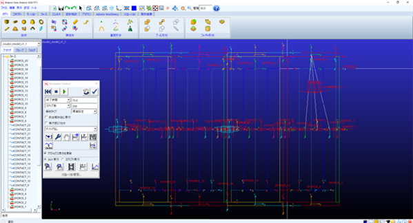

    The model is below.

    I still can't understand what it is that you are trying to model. But as there are multiple contacts in your model, I suggest that you use the HHT integrator. Make sure to use an appropriate HMAX to capture the frequencies of interest. And set HINIT=HMAX/100.
