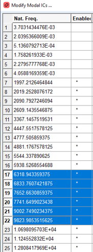

    say, for your NVH study you are interested in frequencies up to 6 kHz then apply modal damping of 0.02 (2% of critical damping) up to that frequency and then step up to 1.0 of modal damping (critical damping) over some frequency range. My tutor used to say, have at least 6 modes over that range if possible, to let solver have a smooth transition from low damping to critical damping.
    STEP(FXFREQ, 6.0E3, 0.02, 1.0E3, 1.0)
    flex_body_freq
