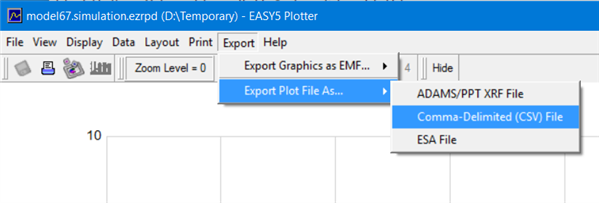

    2) You can open the Plotter separately and then open that ezrpd file. Then go to the Export menu and tell it to  Export the plot file to CSV.
    plotter_export
