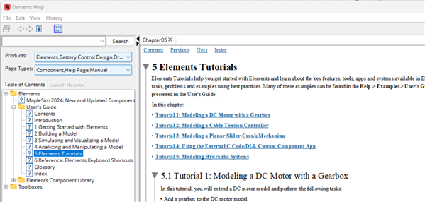

Hello, I am learning easy5 from tutorials however, I found 5 tutorial of Elements. How may i get detaail tutorials of elements software? Best regards, Samet

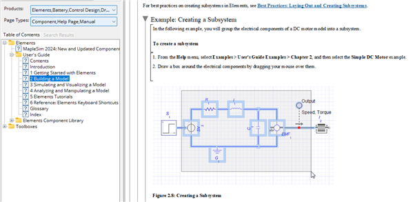

    I assume you mean the Elements Tutorials found in the Elements User's Guide:
    If you look in the preceding sections of the User's Guide (like #2, Building Model), you will find additional exercises that support the topics being discussed. For example:

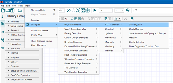

    Finally, there are a lot of example models to look at as well and those can be accessed from the main Elements Help Menu:
    For now, this is the only learning material we have available. In the next few months, however, we will be adding material for Elements on our Nexus Training site. Hope this helps.

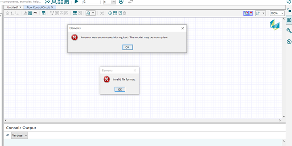

    I tried open one example however I got the below message. Could you help about the problem, please?

    What version of Elements are you using?
  • samet.goner
    0 samet.goner over 2 years ago
    I am using elements 2023.3.
  • Rick Clanton
    0 Rick Clanton over 2 years ago
    I cannot seem to reproduce the issue on my machine.
    Try opening other example models and see if you have the same error with those. If so, I suspect that maybe your installation of Elements is corrupted and would suggest you uninstall and reinstall it.
    If this is the only model exhibiting this behavior, let me know and I can send you another version of this model to try.
