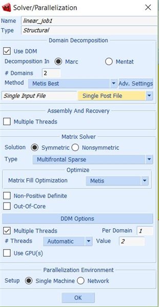

    Command looks good. I noticed you are using DDM for the first run with -nps 4. Have you used multiple post files ( default option), or single post file for this run ?
    post file
    Please use single post file option as shown in the attached image, to use the t16 in next pre state run.
    Kiran
