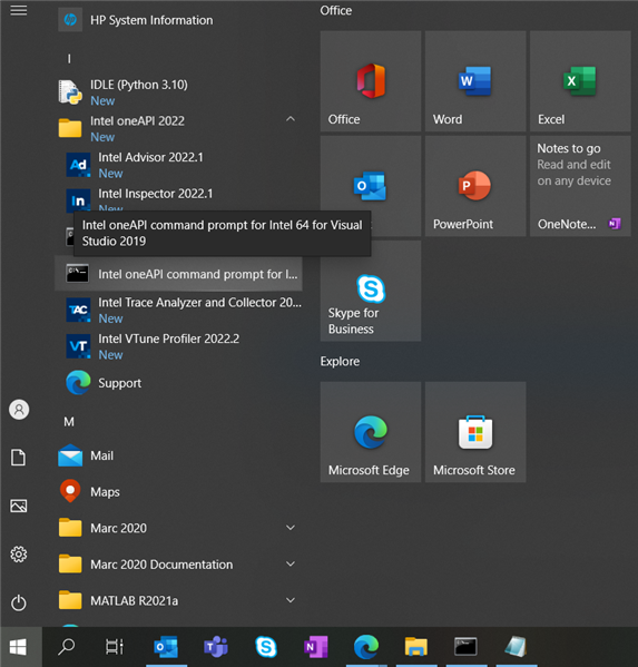

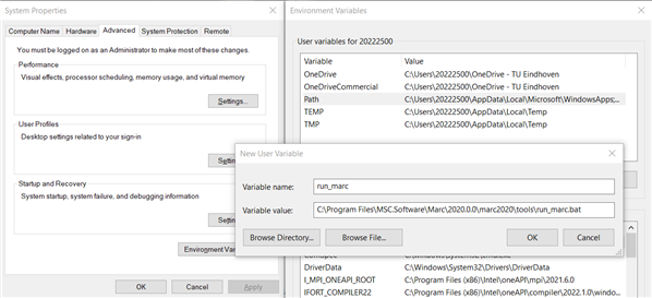

    I use VS 2019 with Inter OneAPI Base Kit + HPC Kit. However, I can only access Marc 2020 and cannot upgrade to 2022. I have an issue similar to @Eduardo Montalto​. In addition to the "LINK: fatal error LNK1181" error, I also get an ifort warning:
    ifort: command line warning #10434: option '/integer_size' use with underscore is deprecated; use '/integer-size' instead
    I created an environment variable to call the run_marc.bat file and added the file path to the Path user variable so I could run it from the OneAPI framework. I got an "unrecognized internal or external command" error when using the run_marc command before doing this.
    Screenshot2
    I then start by opening the cmd prmt for intel 64 VS 2019 to use the correct compiler.
    Screenshot1
    In the cmd prmt, I move to the directory with the test input file: e2x4.dat and the user subroutine: u2x4.f (I took both files from the marc demo files) and used the run_marc command with the input parameter:
    [<some directory>] >run_marc -j e2x4 -u u2x4
