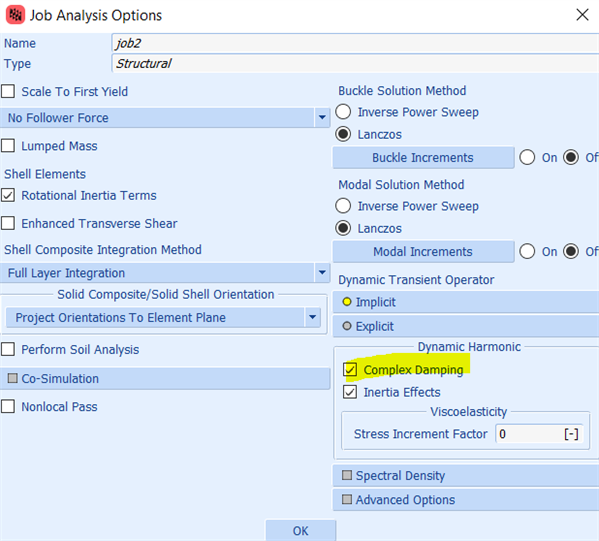

    In the Harmonic and transient analysis, when damping is involved, you need to activate the complex damping option as shown below,
    Kiran
  • M Schmidt
    0 M Schmidt over 2 years ago
    Thanks, that's working.
