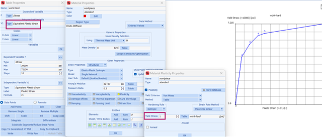

  • Kiranraj Shetty
    0 Kiranraj Shetty 7 months ago
    Dear Michal Lukac,
    Marc expects the plasticity table data in equivalent plastic strain vs true stress form.
    True stress = eng stress * (1+ engg strain)
    'Total true strain = ln(1+engg strain)
    Plastic strain = total true strain - (E/True stress)
    Hence the first point in this table will always be (0, yield stress)
    Use below format to convert the engg stress strain data to Marc data,
    Make sure in the material properties menu, you use yield stress 1 while using actual plasticity data in the table.
    Kiran
