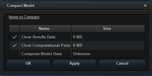

  • Darrel Sinclair
    0 Darrel Sinclair over 7 years ago
    Have you run this model before? It's possible that something has got messed up with an existing computational part. You could try clearing them out and see if that helps. Do this under File/Compact Model:
    Screen Shot 04-25-19 at 03.54 PM
