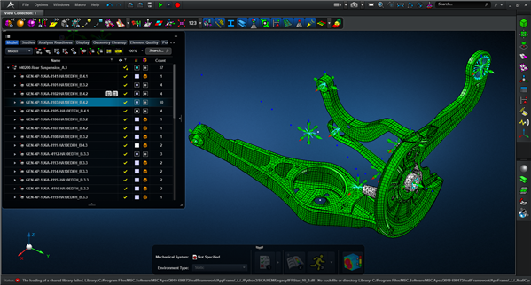

seeing error message "the loading of a shared library failed. ..." after attempting to export bdf for a part or whole model.
Tj Flemings
Tj Flemings over 6 years ago
Export_failure_message
long string of text attempts to identify the library, too long to type so including a screen shot.
Looking for suggestions for what might be the matter here.

    Hi TJ,
    Are you able to provide a database which produces this problem? We will have to investigate it. My intial investigations did not reveal anything. If you don't like to post the database here, you can send it to mscapex.support@mscsoftware.com.

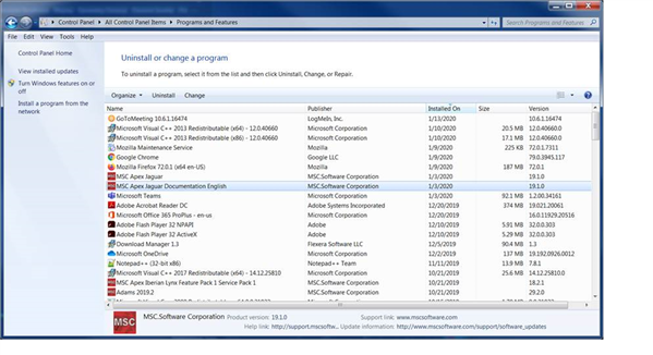

    3) Did you have any other recent updates besides Jaguar on your system? Probably. Here is my installation history…
    installation_history
    If this is a path issue is there a quick fix? My PC is WIN7 Pro 64bit SP1. My colleague who has Jaguar installed on WIN10 does not have this issue.
