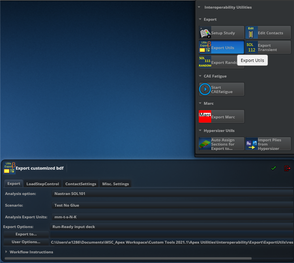

    Did you export the bdf using the Export Tools utility? That's the only way that the changes made by the Edit Contact utility will appear in the bdf.

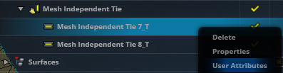

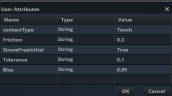

    Note that you can inspect the changes made by the Edit Contacts tool by looking at the User Attributes for the glue:
    Screen Shot 07-07-21 at 08.22 AM
    Screen Shot 07-07-21 at 08.23 AM

    Sorry, that may be my fault. The custom tools I sent you a couple of weeks ago were for 2021, but I can see from the error log that you're running 2021.1. There was a change in the Export Utils tool between the two versions. 2021.1 tools attached.
