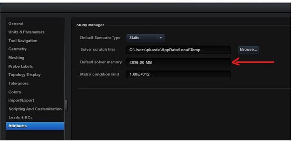

How can I manage very large model with Apex internal solver?
f.cademartori
f.cademartori over 5 years ago
Is this similar to "mem" in Nastran? Sometimes I have some trouble with very large model.
Thanks!
memory
  • Darrel Sinclair
    0 Darrel Sinclair over 5 years ago
    Yes - increase that to allow higher memory usage.
  • karlR
    0 karlR over 5 years ago
    other settings are listed in this article:
    simcompanion.hexagon.com/.../apex-structures-solver-settings-compared-to-nastran-kb8022494
    Another recommendation: Do not use the same disk for solver scratch and for the Apex database, both may create huge files.
  • wvillers
    0 wvillers over 5 years ago
    We use half of our computer RAM, e.g. 128GB and definitely move the scratch to an actual I/O friendly RAID-0 set of drives (NVME in our case)
