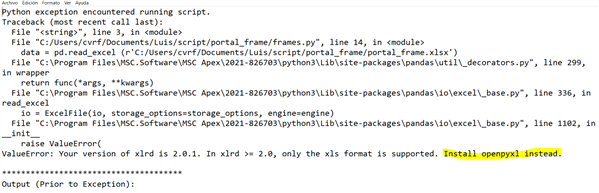

I am trying to extract data from an excel spreadsheet with a macro script. I have imported xlrd into the script but Apex showed me the following message:
image (2)
anybody knows how to install openpyxl?
Thanks
  • karlR
    0 karlR over 5 years ago
    <your path>\MSC Apex\<your_version>\python3\python -m pip install openpyxl
