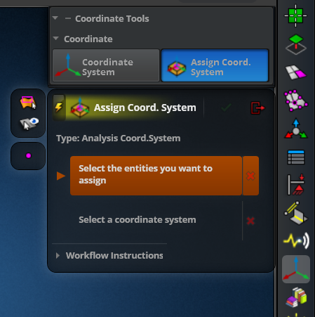

    Coordinate system referenced to any FE entities or LBCs, materials will be automatically written out in bdf.
    We can use coordinate system in various places like material directions, LBC's definitions, nodes coords.
    You can use "assign coord system" tool to reference coordinate system to nodes if required.
    Once its referenced it will be written in bdf, which then will be imported into Patran.
