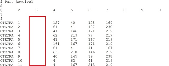

I am using MSC Apex to create .bdf mesh for neutronic simulation on PHITS. I would like to know how to edit the third column on the CTETRA lines directly on MSC Apex. This column is used to group mesh cells into a 'body' in my neutronic software.
Thank you

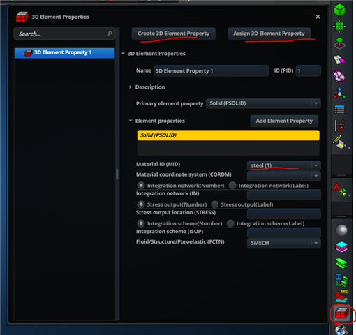

    Alexander Fikri You need to create solid element property and assign it to elements. Follow below steps>> 1. Create material. 2. Go to, 3D element properties >> Create 3D element properties >> Select…
  • Sandip Patil
    0 Sandip Patil over 1 year ago
    1. Create material.
    2. Go to, 3D element properties >> Create 3D element properties >> Select Material >> Assign 3D element property >> Select Mesh / Solid.
    3. Then export bdf from study scenario.

    This really helps. Thank you
