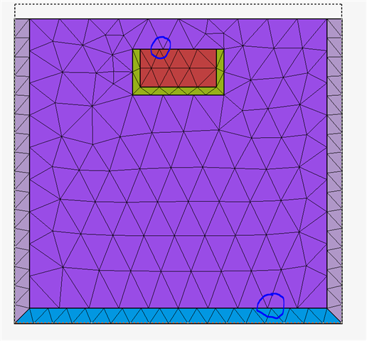

I am meshing a CAD model for use in a neutronic simulation in PHITS, a Monte-Carlo particle transport software. PHITS is really specific with meshes and will not accept the mesh if adjacent tetrahedra are converging into a single node, as depicted in the attached image.
I would like to know if I could fix this with either of these solutions:
  1. Using a feature in MSC Apex that is applied globally to force convergence of vertices for every adjacent cell. I tried meshing the assembly at once rather than on a part-by-part basis, but this problem will still occur

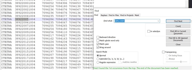

  2. Identifying the problematic nodes and fixing them manually using the node move feature. To do this, I will have to identify the specific cells that are problematic using their CTETRA numbering as shown in the image below. How do I isolate cells based on their CTETRA numbering in MSC Apex?

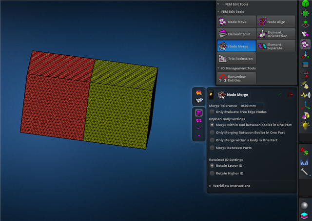

    Alexander Fikri Have you tried the "Node Merge" option from FEM Edit tools? Please note that this option will only be applicable for orphan mesh, so you need to export the BDF of the model and then import…

    Alexander Fikri  Have you tried the "Node Merge" option from FEM Edit tools? Please note that this option will only be applicable for orphan mesh, so you need to export the BDF of the model and then import back for node merge operation. Appropriately select the tolerance for merging. Please check if this helps.

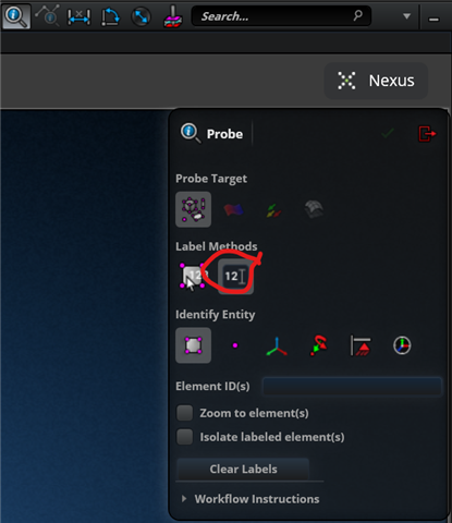

    Regarding finding problematic nodes, you want the Probe tool with Label Methods: Label By ID.
