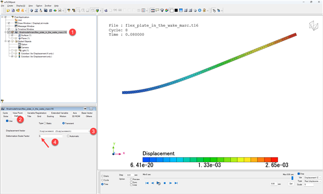

  • Sachin Pande
    Sachin Pande over 1 year ago +1 verified
    1. Click on Filename 2. Select [Deform] tab 3. Select [Displacement] for Displacement Vector 4. Change [Deformation Scale Factor] Please refer image below With deformation scale of 1 With…

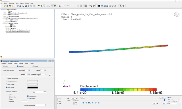

    With deformation scale of 5
