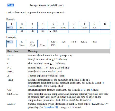

Hello All,
I am trying to find a way how I can read a excel file into patran for my material creation.
Lets see in my excel file I have material values for Al 6061 (young's modulus, density and poisson's ratio) . how can I read them into patran so that I do not have input these values manually ?
Is there a specific excel format these values need to be in order for patran to read them and create the material tab?
Thank you in advance​

    If you have material data in Excel and want to import it to Patran, the easiest way, in my opinion, is to format the data into a Nastran card, such as MAT1, then import the data as a BDF.

    To make anything into a Nastran card that can be read into Patran, such as MAT1, you'd have to follow the formatting definition as described by the Quick Reference Guide.
    I took a screen shot of the page for MAT1 below.
    mat1_QRG
    In the Example, a material with a Young's Modulus of 3e7, Poisson's Ratio of 0.33, and other properties that are inserted into the proper field.
    You would have to format your data in such a manner, following the spacing rules for the fields, or using commas to separate the fields.

    It worked!
    I used the following approach
    1) Created an excel file and each column represented grid entry per the QRG for MAT 1
    2) I saved the ​file as .csv  (This separates all the columns into comma so patran can read it)
    3) Rename the .csv file as .bdf
    4) import into patran as bdf
