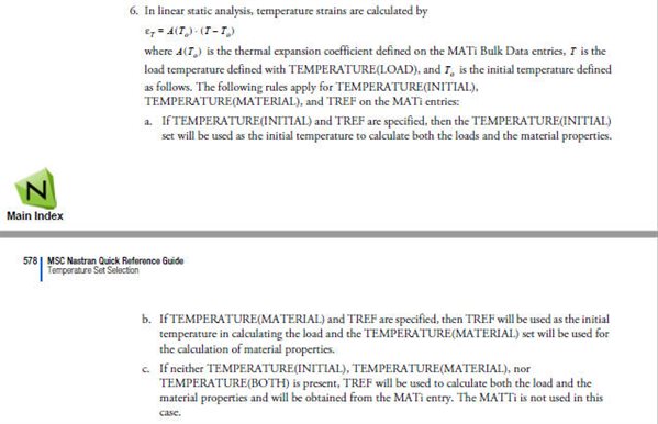

Is there any information that I can use on how to give thermal load?
I am planning to do a simple SOL 101 analysis of a cantilever beam. I want to give a temp gradient of approx. 100 and review the stress and strain .
  • edwin.goei
    0 edwin.goei over 7 years ago
    The most informative documentation exists in the Nastran Quick Reference Guide under the Case Control entry for TEMPERATURE. Specifically Remark 6, which I screenshot below:
  • edwin.goei
    TEMPERATURE

  • shaheer.iqbal
    0 shaheer.iqbal over 7 years ago
    Thanks,
    Quick question, ​
    suppose we have 5 nodes (Grid Points), when we apply nodal force (load) as 10, the total load will be 50 (10 * 5)
    while the same is not true for temp, if I apply nodal temp of 100,each node will have a temp of 100 but it will be more like a uniform temperature distribution of 100. (I do not have any initial temp defined, this 100 is serving as a temperature gradient)
    Correct?
  • Arthur Hickson
    0 Arthur Hickson over 7 years ago
    If you have a temperature set specified in the case control then it will be used to calculate the thermal strains in the elements. e.g:
      TEMPERATURE(LOAD) = 1
    will refer to the set 1 temperatures.
    For the temperatures to give any thermal effect structurally the expansion coefficient (alpha) needs to be specified for the material on the MATi entries.
    The thermal strain(Alpha * Delta(T) ) that is calculated in an element will use the specified temperature (in your example say 100) and another temperature - the initial temperature to calculate the Delta temperature. As Edwin says the rules for the initial temperature are in the Notes of the case control Temp entry in the quick reference guide. You say you do not have any "initial" temperature however if you specify Alpha on the MAT1 card then the TREF value on the MAT card will be 0.0 unless otherwise specified. With no initial temperature specified then TREF will be used for the initial temperature.
