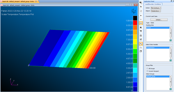

I have a thermal input to my model. The temperature is provided to all nodes through TEMP cards. How to make a fringe plot of this thermal load?

    Import the TEMP cards if you haven't already. This should create a temperature load in Patran. Now you can use Plot Contours in the Loads/Boundary Conditions form to see the fringe plot, e.g.:
    Screen Shot 11-23-22 at 12.22 PM
