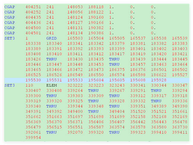

How to input set3 data and output set3 cards to bdf using Patran?
How to import set3 cards into Patran and view them?
  • Edwin Goei
    0 Edwin Goei 10 months ago
    Here's an article on how to write out SET3 from Patran:
    https://simcompanion.hexagon.com/customers/s/article/bulk-data-card-set3-for-elements-output-kb8024519
    And here's an article on how to import SET3 cards into Patran to create groups:
    https://simcompanion.hexagon.com/customers/s/article/Nastran-SET3-Card-import-with-the-TABSCTL-card
    You will find the sample BDF in the article's "File(s)" section. I include the video demo below:
    nexus.hexagon.com/.../demo_5F00_set3_5F00_patran.mp4
