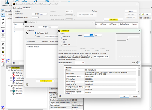

How can I model grooves on shafts as per different standards and supply corresponding factors as well?

    We can define a groove for a shaft step from the "Step Feature" window. In-case the grooves are to be defined as per a standard, then head to - Analysis settings > Ratings > Shafts and choose from…
    In-case the grooves are to be defined as per a standard, then head to - Analysis settings > Ratings > Shafts and choose from different available standards. If you click on "Options", different factors can be manually supplied.
    For more info have read through this tutorial - SF1: Shaft Fatigue Analysis
