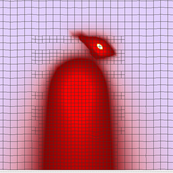

Hallo, In simufact laser welding simulation, the heat source deviates from defined path (may due to deflection of plate). Results in the sudden rise of temperature along the laser path. Used 0.3 mm mesh and 0.005s time step. Anyone help me to solve.
sivasakthi.pachiyappan
sivasakthi.pachiyappan over 3 years ago
deflection of heat source

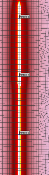

laser path
In this above picture, you can see the suudden jump of temperature in the path .

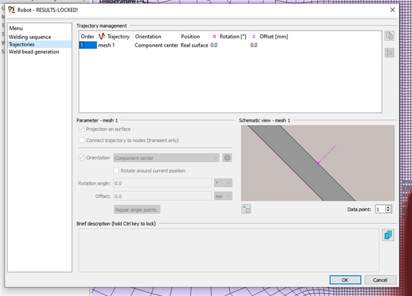

    You can show the trajectories and the active heat sources in the result view and check if they are affected by the deflection. In this case you can try to activate these options for the robot:
    Robot > Trajectories: "Projection on surface"
    and "Connect trajectory to nodes", the latter functions only if the sample points of the trajectory are close enough to nodes of the fillet, if for only one sample point no close node found then this option will be ignored.
  • sivasakthi.pachiyappan
    0 sivasakthi.pachiyappan over 3 years ago
    dhdgh

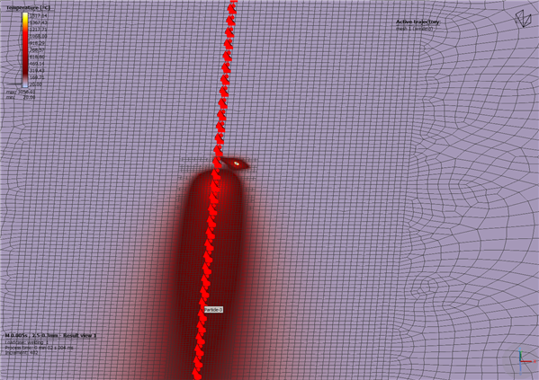

    You can see the robot settings in above picture and trajectory view
  • abdullah.kzzo
    0 abdullah.kzzo over 3 years ago
    Hi sivasakthi.pachiyappan
    to be able to check the trajectory, if it is still on the plate?, would you please send a picture in the x-view (maybe with clipping planes)
    Found the solution. Used different heat source depth in volumteric and surface. That's why it showed wrong heat input.
