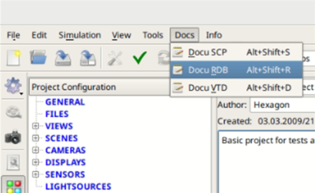

    Opening the RDB Documentation
    You can open the RDB documentation using either of the following methods:
    Option 1: From VTD GUI
    Open VTD GUI → Docs → Open Docu → RDB
    Option 2: Directly from the installation directory
    <VTD Installation Directory> → Doc → RDB_HTML → index.html

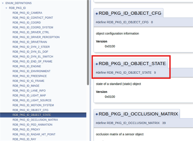

    C. Enum Definitions
    This is one of the most frequently used sections. It contains all RDB enumerations (enums), such as RDB_PKG_ID, RDB_OBJECT_TYPE, RDB_SENSOR_TYPE, and RDB_COORD_TYPE, which define the possible values a field can take and help translate numeric values into meaningful RDB concepts.
    Enums represent a single valid value. Suppose an RDB package contains: pkgId = 9
    Go to:
    Modules
    └── Enum Definitions
    └── RDB_PKG_ID
    You will find: RDB_PKG_ID_OBJECT_STATE = 9
    Now we know package ID 9 represents Object State data. This is usually the starting point for understanding any package.

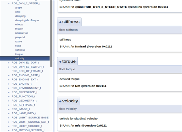

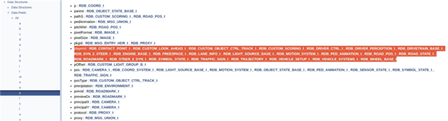

    Every structure page contains a Data Fields section. Data Fields is a reverse lookup section that helps you find which RDB structures contain a particular field name. Instead of asking "What fields are inside RDB_OBJECT_STATE_t?" it helps answer "Which structures contain the field playerId or pos?"
    Example 1: If you search for: playerId
    you'll see a list of structures such as: RDB_DRIVER_CTRL_t, RDB_ROAD_POS_t, RDB_WHEEL_BASE_t, RDB_ENGINE_BASE_t etc.

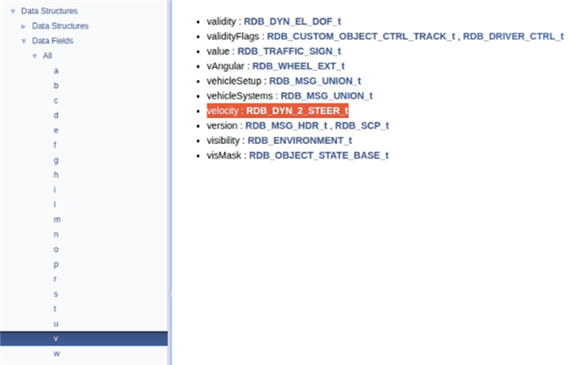

    Example 2: Using the Data Fields Section to Find Vehicle Velocity
    Suppose you want to find where vehicle velocity is stored in RDB.  In Data Structures → Data Fields, search for: velocity or click on ‘v’
    You may find only: velocity : RDB_DYN_2_STEER_t
    This indicates that velocity is used in a specific dynamics-to-steering interface package and is not the general vehicle speed field most users are looking for.
    Additionally, clicking on RDB_DYN_2_STEER_t navigates to the structure in which this velocity is stored.

    Worked Example: How to Read an Unknown Package
    Suppose your RDB Viewer or parser reports:
    pkgId = 9
    Step 1
    Go to:
    Modules
    └── RDB_PKG_ID
    Find: RDB_PKG_ID_OBJECT_STATE = 9
    Now we know the package is: OBJECT_STATE
    pkgId = 9
    Step 1
    Go to:
    Modules
    └── RDB_PKG_ID
    Step 2
    Go to:
    Data Structures
    └── RDB_OBJECT_STATE_t
    Step 3
    Study the structure. You will find:
    RDB_OBJECT_STATE_BASE_t
    RDB_OBJECT_STATE_EXT_t
    Step 4
    Open the referenced field definitions.
    For example: ‘category’ may refer to: RDB_OBJECT_CATEGORY
    Open the corresponding enum to decode the value.
    Step 5
    If additional detail is needed, open ‘Files → viRDBIcd.h’ to view the exact implementation.
    Key Takeaway
