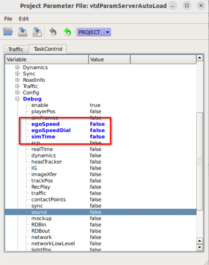

    The EGO speed , Speed-dial , and Simulation time are debug options that can be configured in TaskControl via the ParameterBrowser . To remove the entire speed dial display in the IG window: Open…
  • Ajay Gopidas
    0 Ajay Gopidas over 1 year ago
    The EGO speed, Speed-dial, and Simulation time are debug options that can be configured in TaskControl via the ParameterBrowser.
    1. Open the VTD GUI.
    2. Navigate to ParameterBrowser > TaskControl > Debug.
    3. Set the following parameters to false:
      • egoSpeed
      • egoSpeedDial
      • simTime
    4. Save the changes
    This will disable all three debug elements.

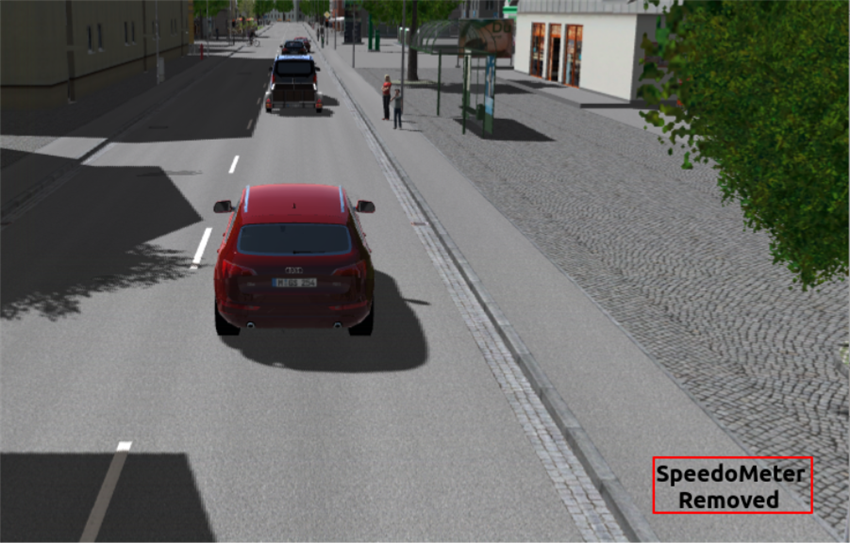

    Note: If only the Speed-dial should be hidden while keeping EGO speed and Simulation time visible, set egoSpeedDial to false and leave the other two parameters to true.

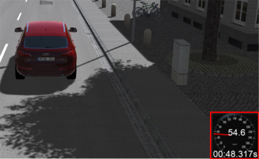

    Before:
    After:
