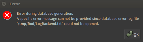

How to eliminate the error that occurs during Database generation in ROD

    The error during database generation typically occurs due to an incorrect Python version or if Python is not properly configured.
    Please note the following version requirements:
    • ROD versions up to 2023.4 require Python 2.7.15 for track generation.
      • Untill Ubantu 20.04: sudo apt-get install python
      • Ubuntu 22.04 and later: sudo apt-get install python2
    • ROD 2024.1 and later versions require Python 3.8 or later for track generation.
      • sudo apt-get install python3
    Once the appropriate Python version is installed and configured, you can verify the active version using: python --version
    If multiple Python versions are installed, you may need to configure Python alternatives to switch between Python 2 and Python 3.
    Please follow the steps below to configure the correct Python version:
    1. Install Python 3 (if not already installed):
    2. Check all available Python versions on your system:
      • ls /usr/bin/python*
        Ensure the required Python version is listed.
    3. Check whether Python alternatives are already configured:
      • sudo update-alternatives --list python
        (If alternatives are listed, note the selection numbers for the next step.)
    4. Configure Python alternatives (one for Python 2 and one for Python 3):
      • sudo update-alternatives --install /usr/bin/python python /usr/bin/python2 1
      • sudo update-alternatives --install /usr/bin/python python /usr/bin/python3 2
    5. Select the required Python version:
      • sudo update-alternatives --config python
        Enter the selection number corresponding to the required version (Python 2 for ROD ≤ 2023.4, Python 3 for ROD ≥ 2024.1).
    6. Verify the active Python version:
      • python --version
    If the issue persists after configuring the correct Python version, please reach-out to our support, and we will be happy to assist further.
