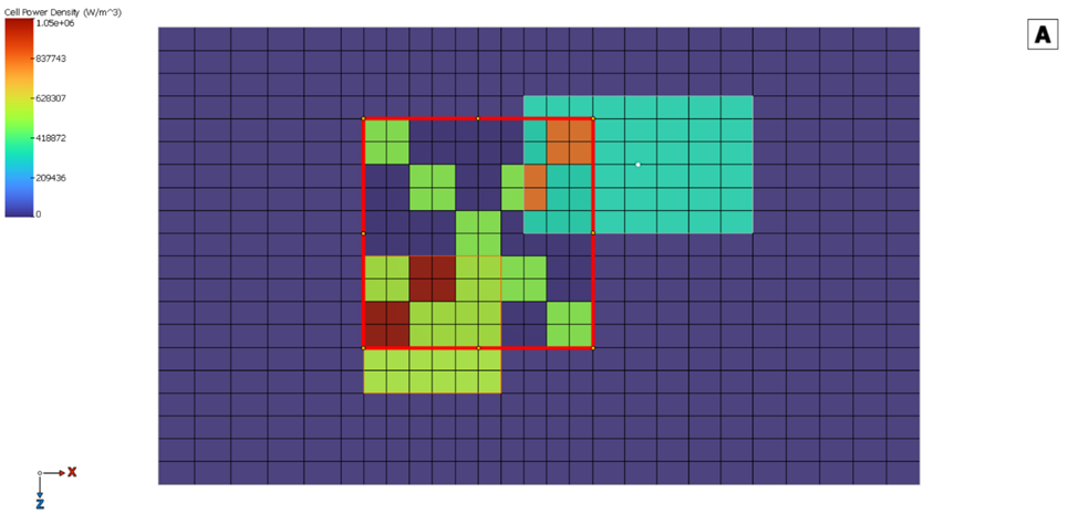

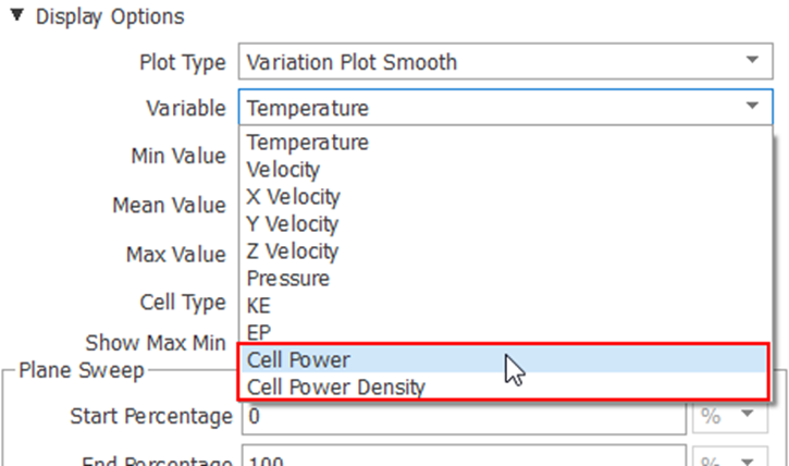

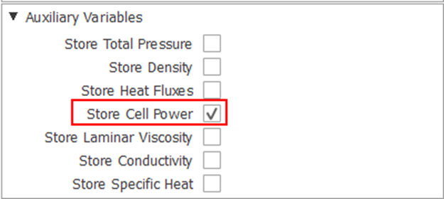

Power Auxiliary Variable
An auxiliary variable, Store Cell Power, has been added to Solution Control. When selected, two new plot types, Cell Power and Cell Power Density, are available to be plotted on a result plane.
Overlapping Power Sources
Celsius EC Solver now supports overlapping sources of power in Subcomponents, Solid Obstructions, and Heat Sources, allowing for a more accurate calculation of power distribution over these objects.
