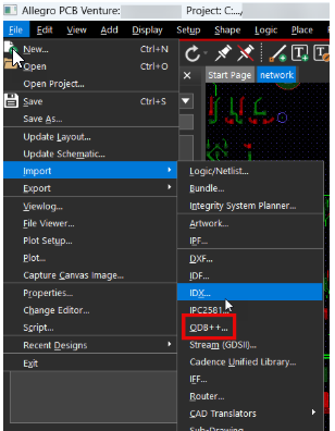

The most robust and recommended approach is ODB++ > Allegro > PowerSI Workflow.
Steps:
  1. Import the ODB++ file into Allegro.
  1. Verify and configure:
    • Rigid‑Flex zones
    • Stackups for rigid and flex regions
  1. Save the design as an Allegro .brd file.
  2. Import the .brd file into PowerSI for simulation.
This workflow (ODB++ > .brd > .spd) is considered more stable and reliable especially for complex Rigid‑Flex designs.
