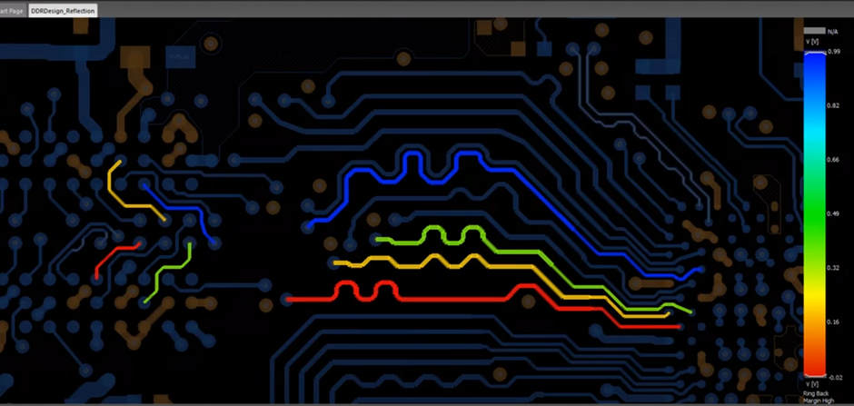

Our intuitive analysis workflows allow you to simulate, analyze, and resolve signal reflection problems directly on your canvas. Simply select the nets of interest and initiate the analysis.
Easily Identify and Fix Signal Reflection Issues

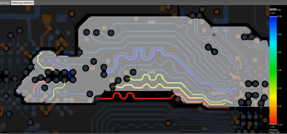

In this example, we're analyzing a DDR data net. The signals are color-coded to indicate the level of reflection, and you can view detailed information in a table. The red-coded DQ net shows a negative ring back margin, indicating excessive ringing due to impedance mismatch caused by a split plane.
Design Tip: Optimize Your Design
To fix this issue, move the reference plane to minimize impedance mismatch and re-run the analysis.

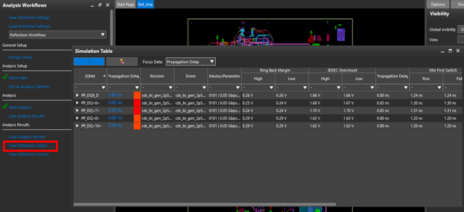

The Reflection Table provides a comprehensive view of voltage and timing measurements, including ring back margin, propagation delay, and more.
