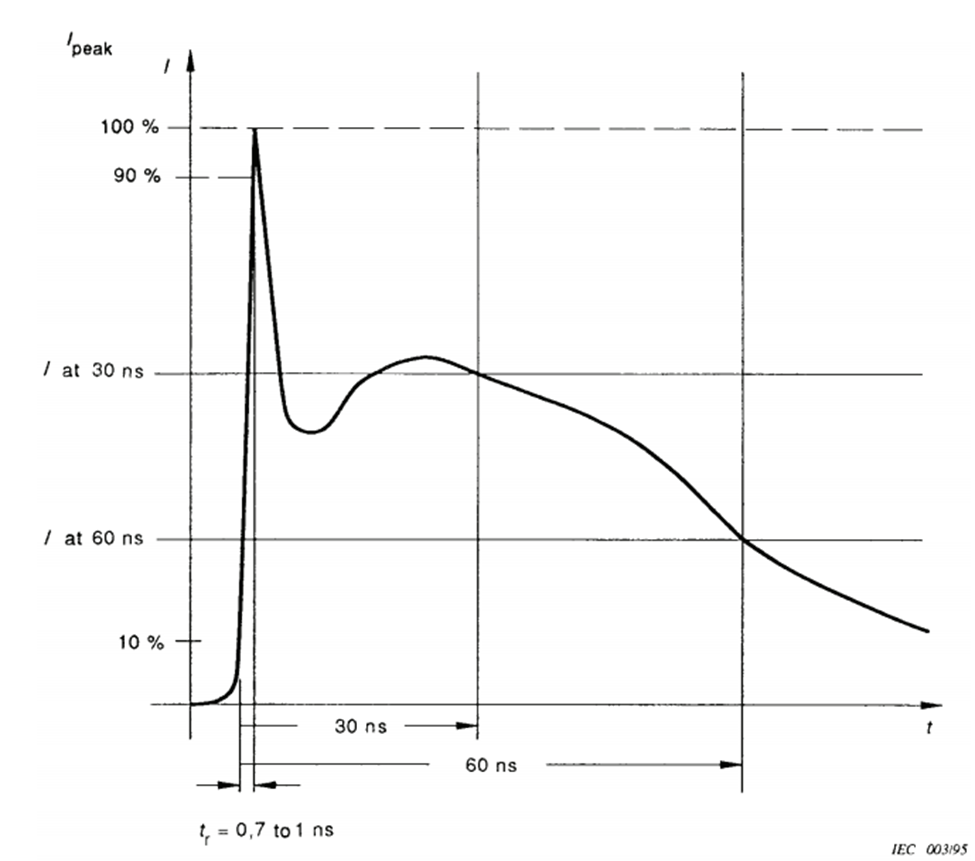

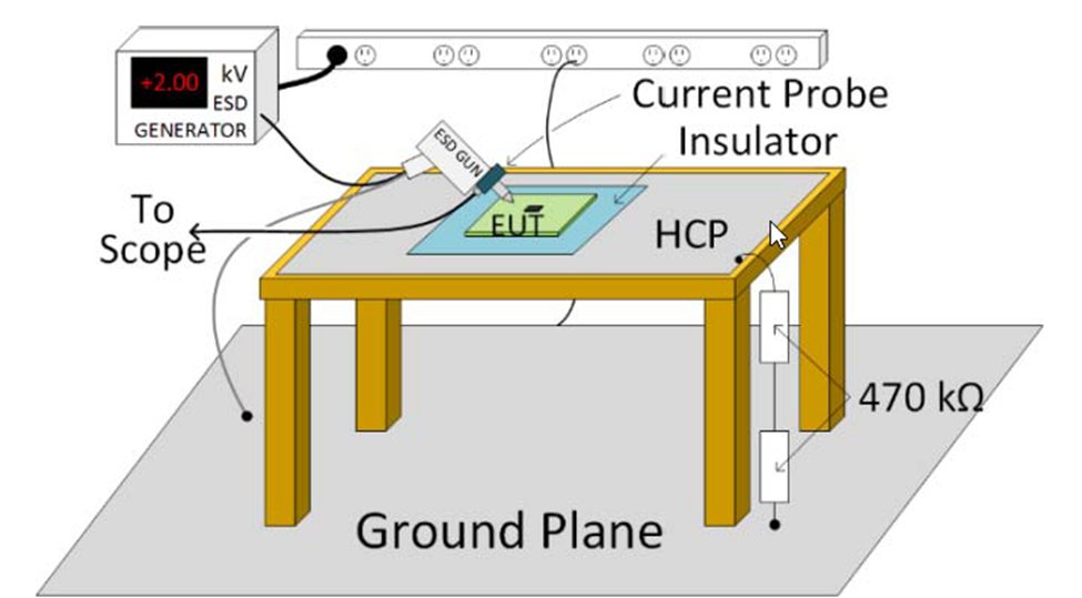

IEC-61000-4-2 Standard:
The IEC-61000-4-2 standard defines four levels of ESD protection using two different discharge mechanisms: contact discharge and air discharge. The standard provides a physical test setup and defines a typical discharge event current waveform. This waveform is characterized by a peak current and specific current values at 30ns and 60ns.
The following image shows the physical test setup defined by the standard:
A typical discharge event produces the following current waveform. In the following image, the peak current is given above, while the current at 30ns and 60ns are also given by the standard:

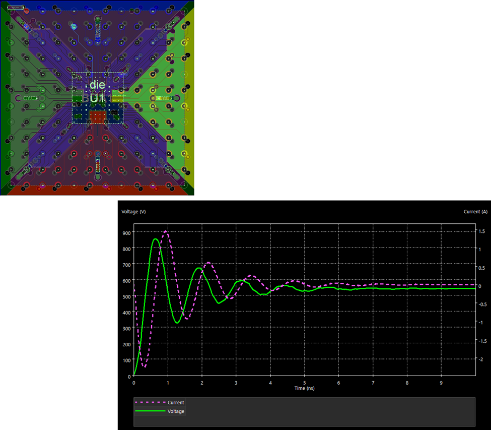

SpeedEM ESD Analysis:
SpeedEM can be used to perform ESD analysis on package designs. The following steps are involved:
  1. Providing the default ESD gun model circuit: This involves injecting the ESD current into the package design using a default ESD gun model circuit that follows the IEC-61000-4-2 standard.
  2. Specifying the necessary steps to observe the ESD phenomenon: This involves setting up the simulation to observe the ESD phenomenon on a package design.
Analyzing the ESD waveform: This involves analyzing the ESD waveform to determine the necessary steps to set up ESD protections.
