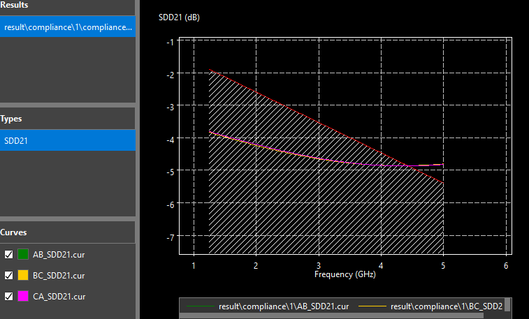

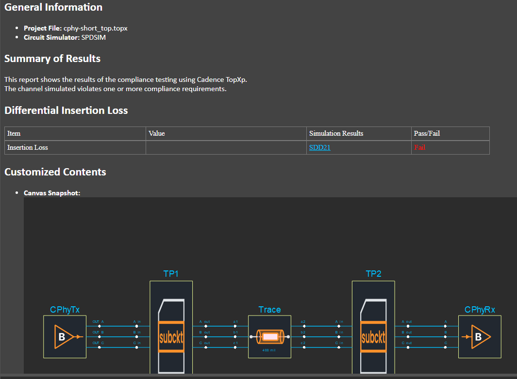

Why Cphy compliance demo simu IL result not pass? only 400mil length

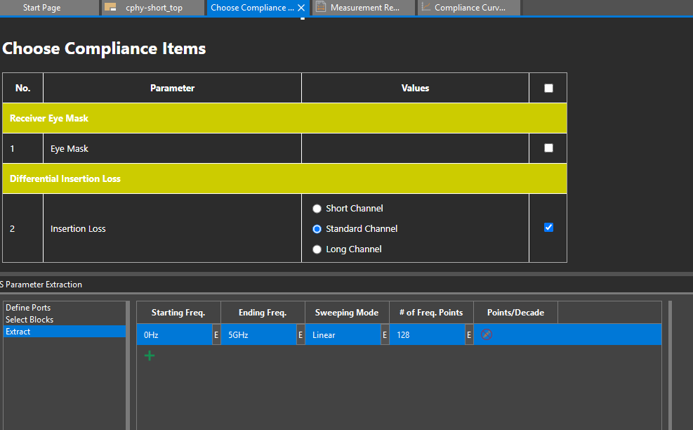

    You can choose either the Standard or Long Channel Insertion Loss option in Compliance Check.

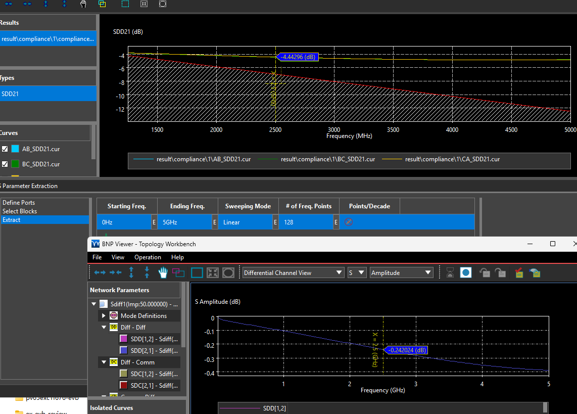

    Even if use Standard Channel ,the  Compliance DIFF IL value still Unreliable。Because use tools  S Parameter Extract Result very small
