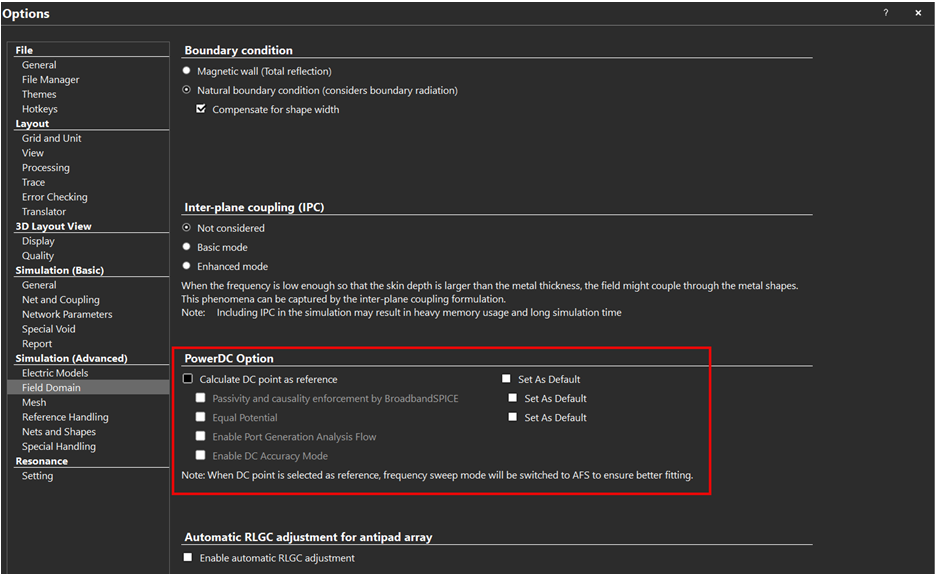

Hi Experts,
I am currently working on a high-speed PCB design that requires both Power Integrity (PI) impedance profiling and time-domain transient SPICE simulations. My analysis needs to cover the entire frequency range-from static  DC up to several gigahertz.
When I run standard AC S-parameter extractions in Hybrid Solvers, the solver extrapolates data at low frequencies (below 100 kHz down to 0 Hz). As a result, the low-frequency plane resistance (R_dc) isn't accurate, which distorts low-frequency die-bump impedance (Z_die) plots and results in miscalculated bulk decoupling capacitor requirements.
Additionally, if I run transient circuit simulations using these extrapolated models, my SPICE solver often experiences convergence issues due to non-physical DC offsets.
How can I configure PowerSI to include an exact 0 Hz static DC point in my S-parameter extractions so I don't rely on mathematical extrapolation?
Thankyou in advance.

    Hi Cistheta,
    Thank you for your question.
    When accurate DC-to-high-frequency behavior is required, relying on low-frequency AC extrapolation down to 0 Hz may not provide an accurate DC reference. PowerSI provides a DC–AC fitting feature that uses PowerDC to calculate the static DC solution and incorporates it into the S-parameter model.
    To obtain an accurate static 0 Hz reference in PowerSI, enable the Calculate DC point as reference option under:
    Tools → Options → Edit Options → Simulation (Advanced) → Field Domain → PowerDC Option
    Alternative: Merge Existing DC and AC Models
    If you already possess a standalone  DC model (from PowerDC or measurements) and a separate high-frequency AC S-parameter model (e.g., starting at ), you do not need to re-run the full EM extraction.
    PowerSI provides the Merge DC+Normal data feature, which allows the DC and AC datasets to be combined into a single S-parameter model.
    Please let me know if you have any further questions.
