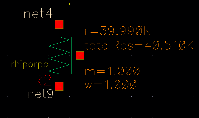

I have to design an amplifier in CMOS 065nm  in which I want to use three terminal resistor from this technology so that when I make layout I can easily generate from it source.
Note - Point to use this resistor because it relatively have smaller length then two terminal resistor.
Question-  I want to know how to connect the it's terminal in design and during LVS check does it give error ?
  • You should check the PDK documentation (or contact the foundry) to find out the details of where the bulk node for the resistor should be connected. Often it's a well or something like that - but I wouldn't want to guess (since you didn't say which technology it was - and even if I did know, I'd still suggest you read the guidance from the foundry on how it is supposed to be used.
