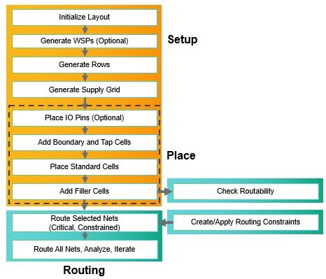

Standard Cell APR Workflow
Let’s walk through a real-time example using Virtuoso Studio MXL for standard cell APR:
Step 1: Initialize Layout
Start by generating layout representations from the schematic. This includes creating PR boundaries, instances, nets, and pins.
Step 2: Setup Design
Configure WSPs, row regions, supply grids, and IO pin attributes. This step sets up the design for placement and routing.
Step 3: Place Standard Cells
Use the Place tab to insert boundary, tap, and filler cells. The Gigaplace engine runs the automated placement, optimizing for area and wire length.
Step 4: Configure Routing
Open the routing assistant to set up routing options. Enable DRC checks and lock colors post-routing.
Step 5: Run Routing
Execute power and signal routing using the supply and route tabs. The assistant supports stripe generation, via insertion, and timing-aware routing.
Step 6: Analyze Results
Use the Routing Results Browser (RRB) to view routed nets, opens, shorts, and violations. This ensures the layout is signoff-ready.
