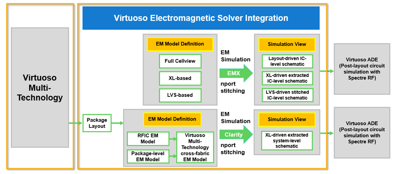

The design flow of the Virtuoso HI across chip and package is shown below:
As illustrated in the flowchart above, the Virtuoso HI platform integrates the Virtuoso Multi-Technology and Virtuoso electromagnetic flows.
1. Virtuoso Multi-Technology: It is Cadence’s multi-technology layout and co-design environment. This environment allows you to simultaneously work across silicon, interposer, package, and board technologies in a unified layout canvas, making it ideal for SiPs, chiplets, and 2.5D/3D ICs.
Key Features of Virtuoso Multi-Technology:
  • Multi-Technology Integration: Co-design across chip, package, and board domains in a single environment.
  • Cross-Domain Layout Editing: Unified editing and alignment of different technology layers with shared references.
  • Technology-Aware DRC/LVS: Applies domain-specific design rules and verification checks for each technology.
  • Support for 2.5D/3D ICs: Enables advanced packaging with TSVs, interposers, and stacked-die integration.Hierarchical Design Reuse: Promotes modular design and reuse of IP blocks and chiplets across projects.
2. Virtuoso Electromagnetic Solver Integration: It is Cadence’s electromagnetic simulation environment integrated within the Virtuoso platform. It enables layout-aware, full-wave EM analysis of RF and high-speed analog designs using the EMX Solver. It helps you model parasitic effects, coupling, and signal integrity directly from the layout.

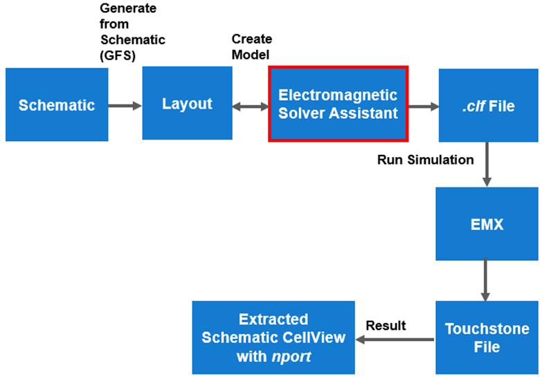

  1. Start with Your Layout in Virtuoso Layout Suite: Begin by creating or importing your layout—whether it’s for a chip, package, or interposer—using the Virtuoso Layout Suite. This is your foundation for accurate, layout-aware EM analysis.
  2. Launch the EMX Solver via Electromagnetic Solver assistant: Next, open the EM Solver Assistant. This is your control center for setting up the simulation environment. It’s intuitive and integrated, so you don’t need to leave Virtuoso.
  3. Choose Your Simulation Scope: Now, decide how much of your design you want to simulate. You’ve got three flexible options:
    • Full Cellview: Simulate the entire layout—ideal for comprehensive analysis.
    • XL-Based: Focus on a specific hierarchy or block that’s XL-compliant.
    • LVS-Based: Use LVS-clean views with black boxing for selective, efficient simulation.
  1. Apply Shape Simplification (if required): To speed things up without sacrificing accuracy, simplify non-critical layout features. This step helps reduce simulation time while keeping essential EM behavior intact.
  2. Run the EM Simulation: With everything set, run the full-wave EM simulation using the EMX Solver. You’ll extract key data like S-parameters, RLGC models, and parasitic effects—all crucial for high-performance RFIC design.
  3. Visualize 3D Currents: Use the built-in 3D viewer to explore current density, coupling, and potential hotspots. This visual feedback helps you quickly identify and resolve EM issues.
  4. Back-Annotate to Your Schematic: Once your models are ready, automatically back-annotate them into your schematic. This ensures your circuit-level simulations reflect real-world EM behavior.
  5. Run Circuit-Level Simulation: Finally, you run the Spectre simulation on your circuit with the EM-accurate models in place. You’re now ready to validate performance with confidence.

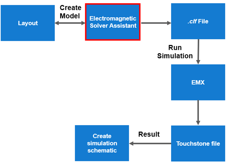

2. XL-Based model:
  • Targets specific nets/instances
  • Ensures schematic-layout alignment

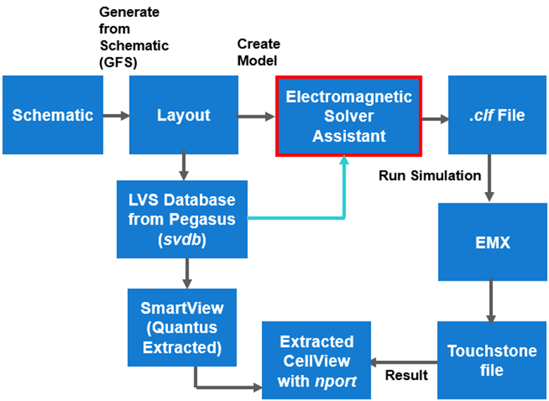

 3. LVS-Based model:
  • Uses the Quantus Smart View Output
  • No XL compliance required
  • Combines parasitic and EM data
