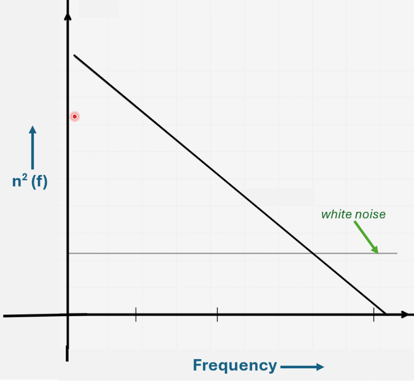

Visualizing Device Noise: The Spectral Picture
Before we set up a transient noise simulation, it helps to picture what device noise looks like in the frequency domain. The noise spectrum graph below summarizes the key features every analog/RF engineer must internalize:
                                                 Figure 1: Noise spectrum
  • A flat white-noise floor that dominates from mid to high frequencies, up to Fmax
  • A 1/f (flicker) noise slope that rises sharply at low frequencies, below the 1/f corner
  • An additional n²/f component, highlighted to show higher-order low-frequency contributions
  • Clear boundaries at Fmin and Fmax, defining the bandwidth over which transient noise is simulated
Why This Matters For Your Design
Real silicon noise is never flat. However, it can have a constant noise curve. Flicker noise dominates close to DC and—through nonlinear mixing in oscillators and PLLs—folds back around the carrier as close-in phase noise and long-term jitter. Transient noise analysis can model the noise folding because it injects noise sources directly into the time-domain simulation of non-periodic, nonlinear circuits.
Figure 1 visually answers the introduction's question: 'why does my PLL lock cleanly in simulation but jitter in silicon?' The 1/f tail and its folding are the culprits, and appropriate choices for Fmin and Fmax ensure those mechanisms are represented in your simulation.
