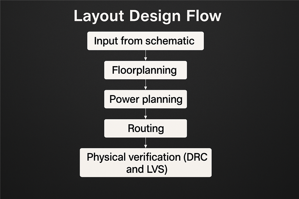

Analog layout design has always involved balancing precision, experience, and iteration speed. Traditionally, it has been an iterative and sequential process. After finalizing a schematic, the layout task was usually handed off to a layout designer, who then translated circuit intent into physical geometry.
This process involved:
  • Interpreting matching requirements, symmetry, and device intent
  • Deciding placement styles (common centroid, interdigitated, etc.)
  • Placing devices, adding guard rings, and routing nets
  • Running checks for DRC, connectivity, and basic feasibility
While this approach works, it often requires multiple back-and-forth cycles between schematic and layout teams. If something didn’t look right, such as excessive area, late realization of missing constraints, and so on, the only option was to redo parts of the layout. And each iteration could take days and weeks to complete. This might slightly increase time to market.
