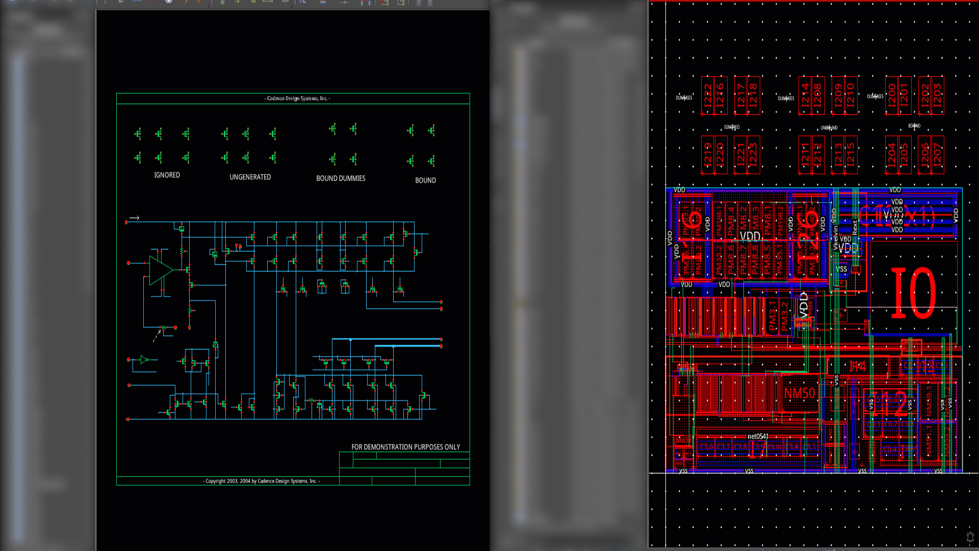

Why Binding Visualization?
Binding establishes the relationship between schematic and layout instances. When these bindings are incorrect or incomplete, the integrity of the design is at risk. Traditionally, designers have relied on tools like the Navigator or connectivity checks within both layout and schematic environments to validate bindings. While these methods provide detailed insights, they fall short of delivering a quick, holistic view of the overall design status.
The Bind Color Map feature addresses this gap by offering an instant, color-coded visualization of binding states across both schematic and layout canvases. This intuitive representation enables designers to quickly assess binding completeness and correctness, ensuring design integrity with greater efficiency.
How Does It Work?
Think of Bind Color Map as a traffic light for your design - simple, visual, and instant.
  • Green = Bound instances and dummies
  • Red = Unbound instances and unbound dummies
  • Blue = Ignored instances and ignored dummies
With this color-coded clarity, you instantly see what’s connected and what’s not. The best part? It’s dynamic; if an instance changes from bound to ignored, the color updates automatically. No refresh, no extra steps - your view always reflects the current design status (as shown in the graphical view below)
