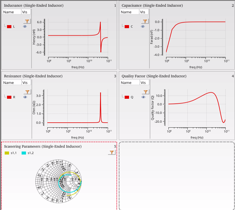

The S-Parameter assistant allows you to load Touchstone (.snp) files and instantly visualize the S-Parameter behavior using the Smith chart. It also automatically derives key electrical characteristics, including inductance (L), resistance (R), capacitance (C), quality factor (Q), and other frequency-dependent metrics—helping you move from raw data to real understanding in no time.
The following figure shows L, R, C, Q, and S-Parameters of a single-ended inductor in a two-port network, plotted using data extracted from a .s2p file.
Electrical and S-Parameter Plots

Modern modules and substrates often contain passive components embedded within large, multiport S-Parameter networks. Analyzing individual elements such as inductors from these datasets can be difficult, requiring you to manually identify terminals, isolate the component, and extract meaningful electrical characteristics.
The S-Parameter assistant simplifies this process by allowing you to select the ports associated with a specific component while automating the rest. It isolates and de-embeds the selected element from the surrounding network, then generates plots such as inductance, impedance, and quality factor (Q). This eliminates tedious manual processing and makes it easy to verify the performance of embedded passive components, even within complex multiport designs.
