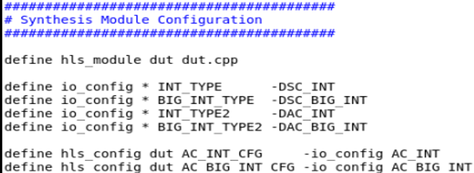

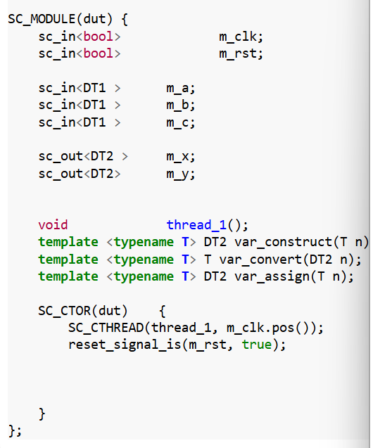

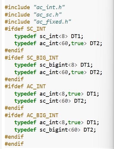

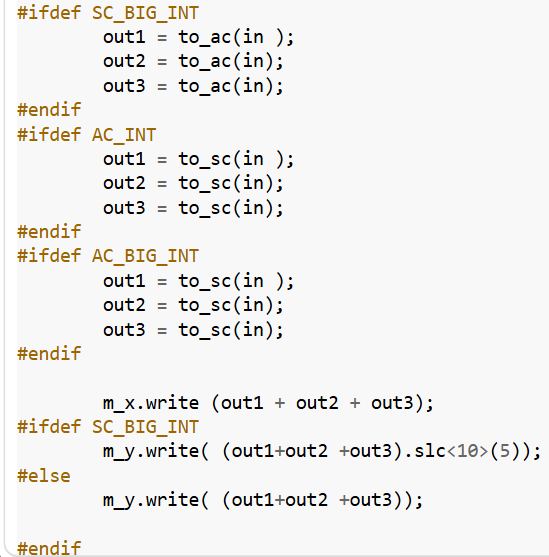

How to Use Compile-Time Configuration and Abstraction to Make a SystemC Design Adaptable Across Multiple Data Types
In SystemC-based HLS flows, developers often work with multiple numeric types such as sc_int, sc_bigint, and ac_int. Each has different precision capabilities, performance implications, and synthesis characteristics. Without abstraction, switching between these types means rewriting large portions of code.
Data types in the source code - defines.h;
Data types in the source code - file.h;
Data types in the source code - file.cpp
The image depicts the way of configuring the design interfaces for the above-defined data types

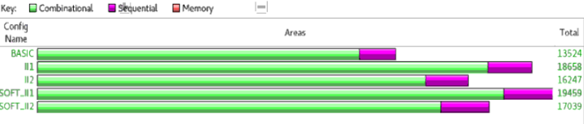

Exploring Using Pipelining Constraints
Pipelining constraints are one of the primary exploration axes in Stratus HLS because they directly trade off throughput vs. area, latency, resource sharing, and clock frequency feasibility. Through pipelining, Stratus HLS allows designers to generate multiple microarchitectures from the same source code, where a single untimed algorithm can yield multiple microarchitectures, each with vastly different performance and cost, simply by tuning pipelining.
What Do the Pipelining Constraints Help Resolve?
When pipeline constraints are applied, Stratus HLS may report that a requested initiation interval is not achievable, that Loop-carried dependencies prevent pipelining, or that resource or memory conflicts stall the pipeline.
These reports help identify and, in turn, resolve:
  • Algorithmic bottlenecks
  • Refine pipeline constraints
  • Adjust loop structure or memory layout
Applying pipelining constraints transforms sequential algorithms into high-performance hardware pipelines while allowing designers to navigate a wide design space using Initiation Interval, Stall modes, as prime parameters.
The image indicates the area numbers for different configurations.

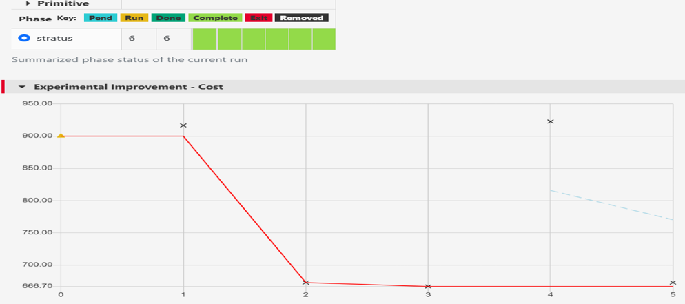

Stratus HLS Integrates with Cerebrus for Automated Exploration
Cadence Cerebrus is a design optimization tool that applies machine learning (ML) to achieve optimal PPA. When applied to Stratus HLS, the goal is to produce the optimal RTL from a behavioral model rather than to optimize a fixed RTL. The Stratus-Cerebrus integration automates exploration and guides it with ML to converge on an optimal result.
Cerebrus is configured with a set of primitives that define the space to be explored and a cost function that determines how PPA will be evaluated. Based on the metrics and primitives set for those scenarios, Cerebrus learns which primitives move the results closer to an optimal target. Cerebrus further explores the values of the enabled primitives and seeks the set that yields the best PPA. Stratus HLS provides utilities for specifying project primitives.
The image illustrates the power of using Cerebrus to explore a design.
How Is HLS Design Space Exploration Performed with Cerebrus Primitives?
HLS is not just about writing SystemC code, but about exploring architectural choices intelligently. And Cerebrus is used in Stratus HLS to accelerate the production of the optimal RTL, rather than to optimize a particular RTL. The flow begins with an hls_config that successfully produces RTL, but that does not yet yield optimal PPA. Here are the key advantages of using Cerebrus for exploration:
  • No code changes required
    • All design exploration is controlled externally via Cerebrus scripts
    • The original SystemC/HLS design remains untouched
  • Exploration-driven optimization
    • Each setup defines a search space of architectural and synthesis choices
    • Includes constraints and goals for PPA evaluation
  • Automated iterative flow
    • Cerebrus repeatedly runs the Stratus HLS synthesis flow
    • Automatically adjusts configurations between runs to explore better solutions
  • Scenario-based exploration
    • Each combination of settings creates a unique design scenario
    • These scenarios are stored as hls_configs in the Stratus database
  • Seamless integration with Stratus
    • Generated scenarios behave like standard HLS configurations
    • Can be further analyzed using the Stratus IDE
  • Real-time tracking and analysis
    • Cerebrus UI provides visibility into:
      • Exploration progress
      • Scenario completion status
      • Comparative evaluation of results

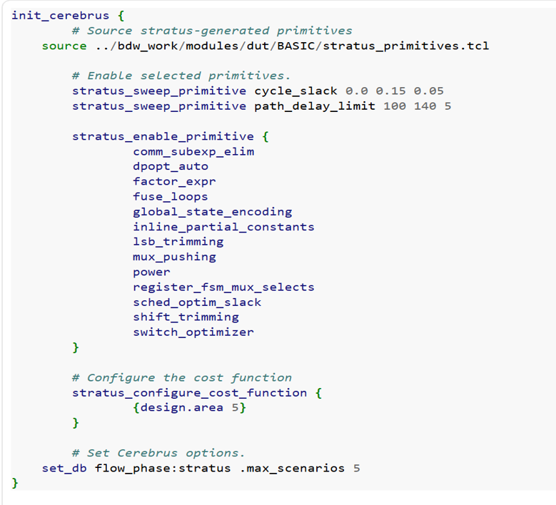

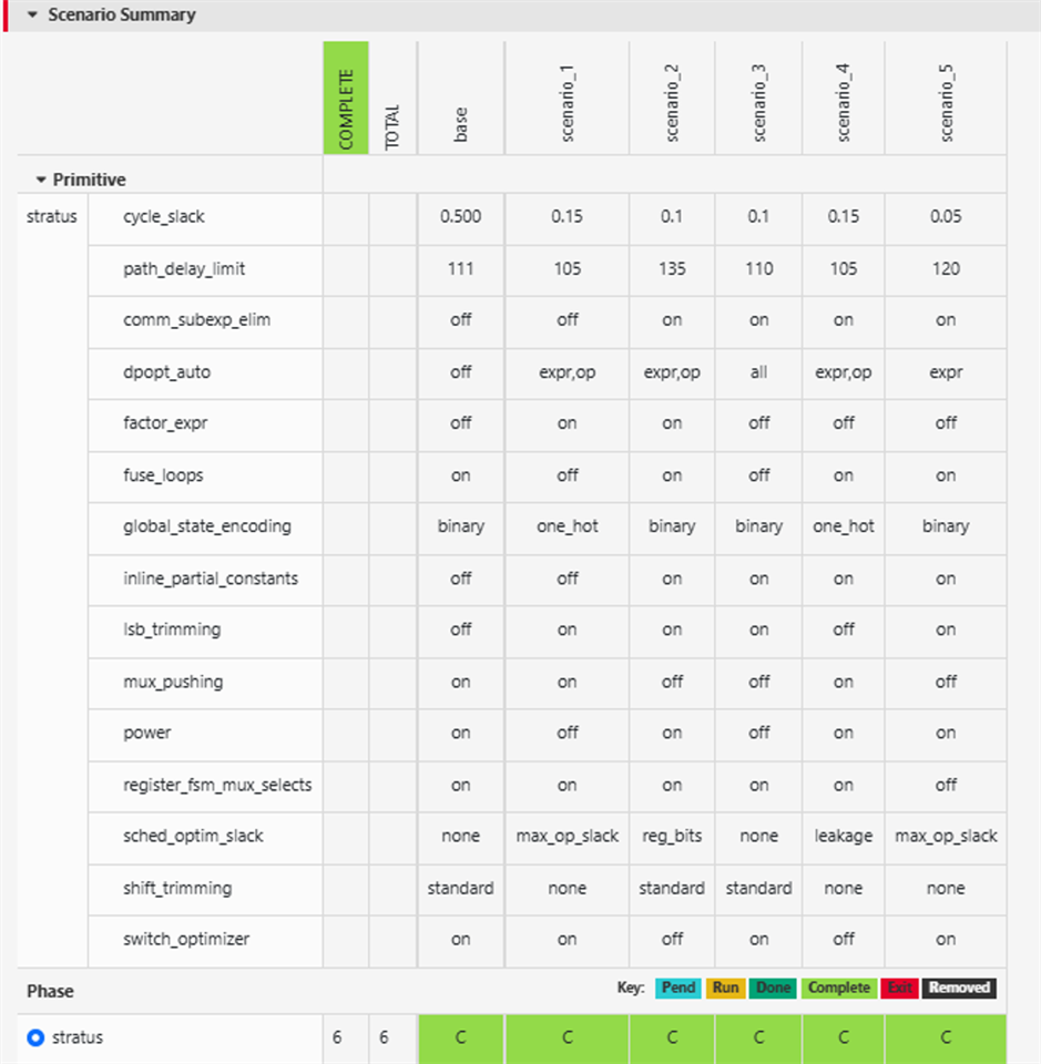

This image illustrates the typical inputs known as primitives in Cerebrus. The details defined by the "max_scenarios" option in the init_cerebrus script help in exploring the design, including the other parameters.

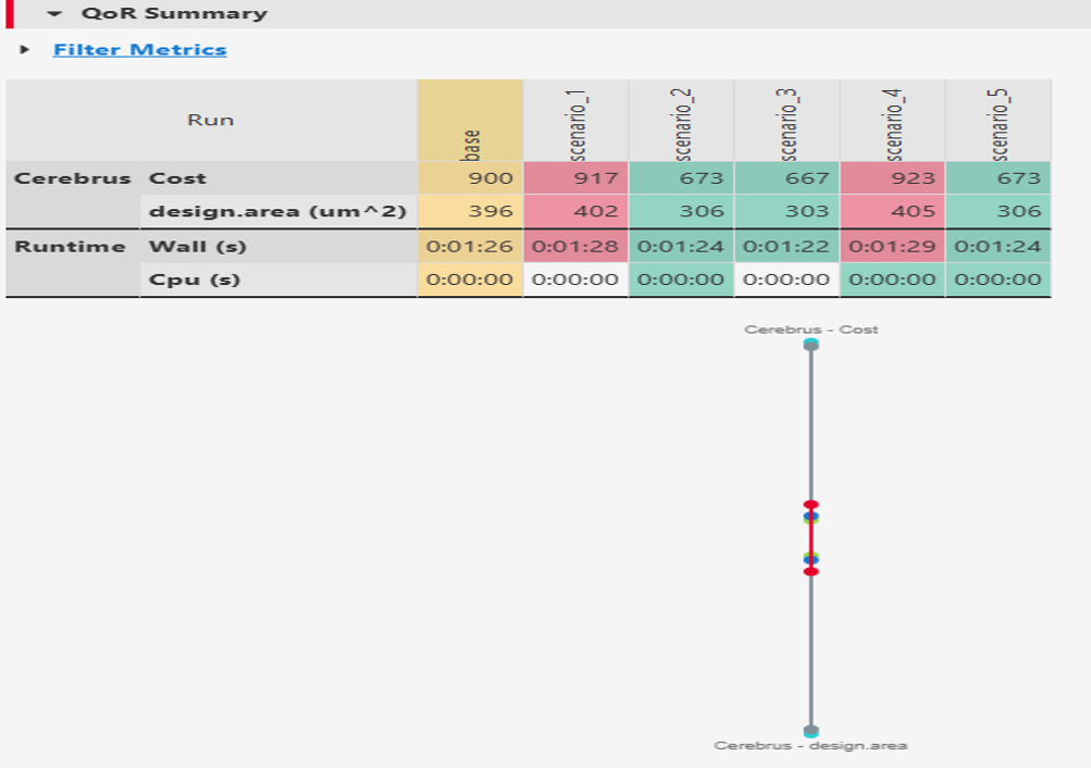

This is design space exploration for multiple combinations of timing constraints, scheduling strategies, and resource optimizations automatically explored by Cerebrus. Instead of manual tuning, exploration is automated, and the design space is covered efficiently, leading to faster identification of optimal architecture.
This image depicts the five design exploration scenarios (scenario_1 → scenario_5) evaluated against a base configuration.
Cerebrus rapidly explores multiple HLS optimization strategies and automatically converges on configurations delivering ~25% better QoR without increasing runtime.
The images show the results indicating the best design, enabling optimal tradeoff decisions
