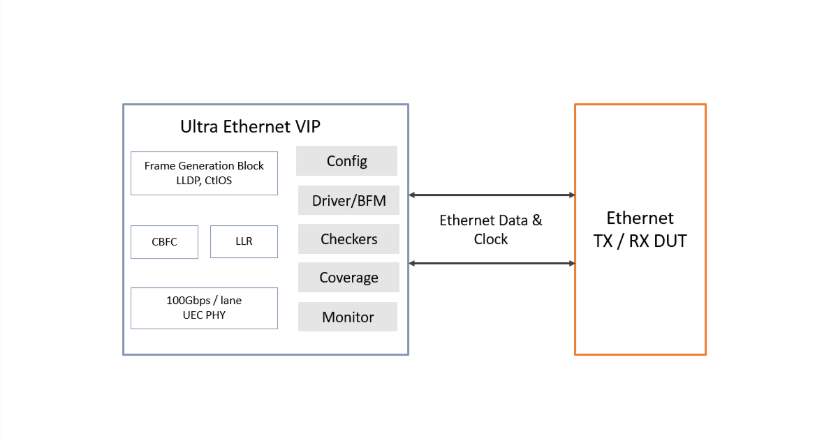

With the availability of the Cadence Verification IP for Ethernet, adopters can start working with these specifications immediately, ensuring compliance with the standard and achieving the fastest path to IP and SoC verification closure. Incorporating the latest protocol updates, the mature and comprehensive Cadence Verification IP (VIP) for the Ethernet protocol provides a complete bus functional model (BFM), integrated automatic protocol checks, and coverage model. Designed for easy integration in test benches at IP, system-on-chip (SoC), and system levels, the VIP for Ethernet helps you reduce the time to test, accelerate verification closure, and ensure end-product quality. The VIP for Ethernet runs on all major simulators and supports System Verilog and e-verification languages and associated methodologies, including the Universal Verification Methodology (UVM). More details are available in the Ethernet Verification IP portfolio.
