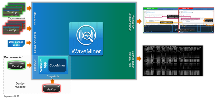

Verisium WaveMiner Inputs and Outputs
Inputs
  • One or more passing waveforms and one or more failing waveforms
  • Generated with two different versions of the same design
  • Analysis scope: Two snapshots or user-defined list of signals/instances
Outputs
  • Text report with ranked culprit signals and simulation time points
  • Visualization in Verisium Debug
  • Interactive navigation through ranked signals and timepoints

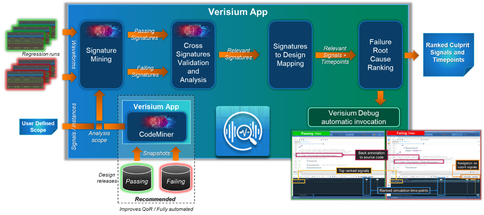

Verisium WaveMiner performs signature mining on passing and failing waveforms, cross-validates the results, and ranks the design signals and simulation timepoints according to their contribution to the misbehavior. The results are visualized in Verisium Debug for detailed analysis.
WaveMiner Functionality
  • Signature mining from multiple passing and failing waveforms
  • Ranking of failure root cause candidate signals and timepoints
  • Automatic invocation of Verisium Debug for detailed analysis
  • Minimizes debug effort and improves the quality of results (QoR)

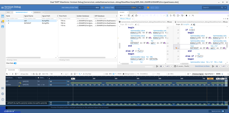

Verisium WaveMiner Dual Waveform GUI View
