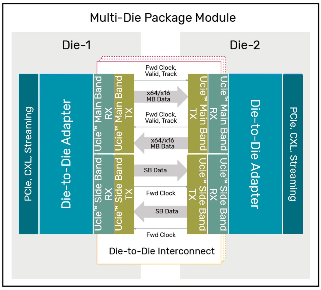

I am often asked, "What is the difference between a traditional SoC die and a chiplet die?" At a high level, the answer is that a traditional SoC is designed as a standalone single-die packaged chip, while a chiplet is part of a larger system of multiple dies packaged together. This simple answer inevitably leads to a more involved answer. To facilitate a system of chiplets, each chiplet must understand how to manage itself within the system. One common misconception is that adding a die-to-die interface to a design equals a "chiplet." While that is part of the chiplet function, it is nowhere near solving all the associated challenges.
To operate as a chiplet, a design must first address a number of considerations. These include how it boots (secure or insecure?), how it's debugged (standalone or across chiplets?), how common resources (such as memory) are managed, how clocking and resets are distributed, how it communicates with other chiplets, and, for designs where safety is crucial, how faults are captured. Finally, all these capabilities should be designed to a common specification, such as the new Foundational Chiplet System Architecture (FCSA), being developed as part of the Open Chiplet Economy (OCE), to ensure multi-chiplet interoperability. The FCSA specification defines common interfaces and protocols between different types of chiplets.
Figure 1. Common Chiplet Interfaces

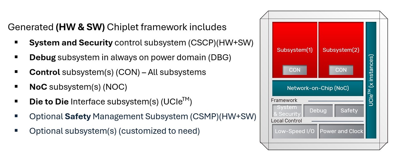

The Cadence Chiplet Framework
The good news for chiplet designers is that Cadence has been pondering the problems of multi-die chiplet integration and interoperability, and the need for specific chiplet management capabilities, for a couple of years now, and has developed a solution. The Cadence Chiplet Framework is a comprehensive hardware and software solution designed to make this transition seamless. The Cadence Chiplet Framework accelerates chiplet development and ensures cross-chiplet interoperability by standardizing common interfaces.
The Cadence Chiplet Framework provides a pre-verified and integrated set of subsystems that manage everything from boot-up and security to die-to-die communication. It acts as the foundational blueprint for creating complex multi-chiplet systems. Let's explore the key subsystems that compose this powerful framework and understand how each component contributes to a successful chiplet-based design.

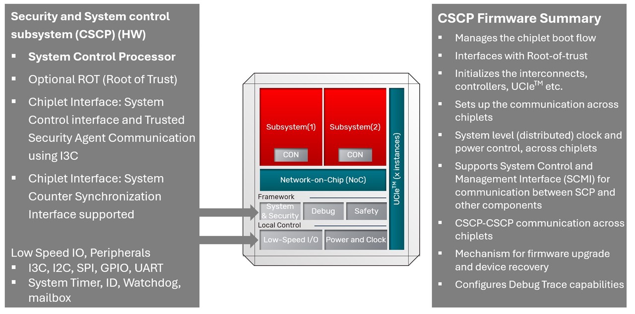

The system and security control processor (CSCP) subsystem is at the heart of the Cadence Chiplet Framework. This critical component acts as the central control system for each chiplet, and every chiplet in the system should include, at a minimum, one CSCP. It is responsible for orchestrating the boot process, managing system-level functions, and ensuring robust security within and across chiplets.
Figure 3. CSCP subsystem

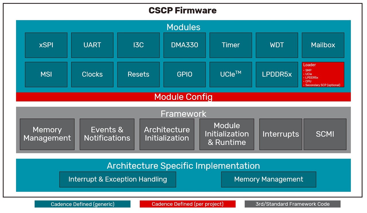

The CSCP includes an efficient and lower-power control processor, which executes dedicated firmware. One of its primary roles is to manage the chiplet boot flow, ensuring that each die powers up correctly and in the proper sequence. It initializes essential components like interconnects, memory controllers, and the UCIe™ interface, setting the stage for communication between chiplets. For security, the CSCP interfaces with a built-in root of trust (RoT), the Cadence Securyzr solution, which handles secure boot, attestation, and lifecycle management, establishing a secure foundation for the system's operation.
Figure 4. Cadence Securyzr, the secure root of trust solution
Key functions of the CSCP firmware include:
  • System-level control: Distributes clock and power control across all chiplets.
  • Communication: Establishes communication pathways between chiplets and supports the system control and management interface (SCMI) for interaction with other components.
  • Security and recovery: Provides mechanisms for secure execution, secure firmware upgrades, and device recovery, crucial for maintaining device integrity in the field.
Figure 5. CSCP firmware

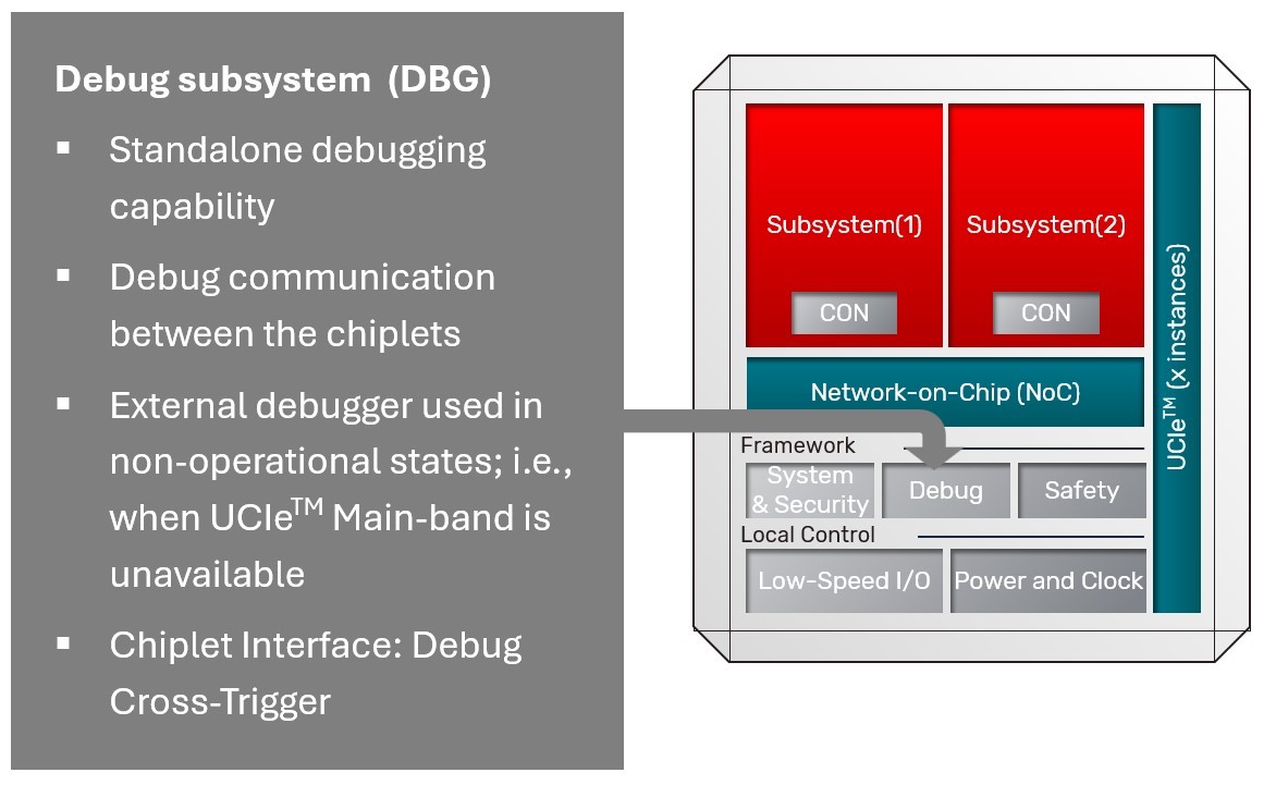

DBG Subsystem
Complex systems require robust debugging capabilities, and multi-chiplet designs are no exception. The debug (DBG) subsystem is housed in an always-on power domain, providing standalone debugging capabilities that are independent of the main system's operational state.
This is particularly important during development and when diagnosing issues in the field. The DBG facilitates debug communication between chiplets and allows an external debugger to be used even when the primary die-to-die interface (UCIe Mainband) is not active. It also supports a debug cross-trigger interface, enabling engineers to synchronize debug events across different chiplets for more effective system-wide analysis.
Figure 6. DBG subsystem

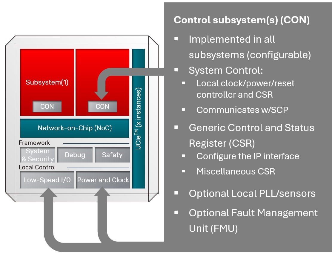

While the CSCP manages the overall system, local control within each subsystem is handled by dedicated control (CON) subsystems. These configurable blocks are implemented throughout the design, providing granular control over local functions.
Each CON includes a local controller for power, clock, and resets. It communicates with the central SCP to ensure its operations are synchronized with the rest of the system. Additionally, the CON features generic control and status registers (CSRs) that are used to configure IP interfaces and manage miscellaneous functions. For advanced designs, a CON can also integrate optional components like local phase-locked loops (PLLs) for clock generation, on-die sensors for monitoring, and a fault management unit (FMU) for detecting local errors.
Figure 7. CON Subsystem
