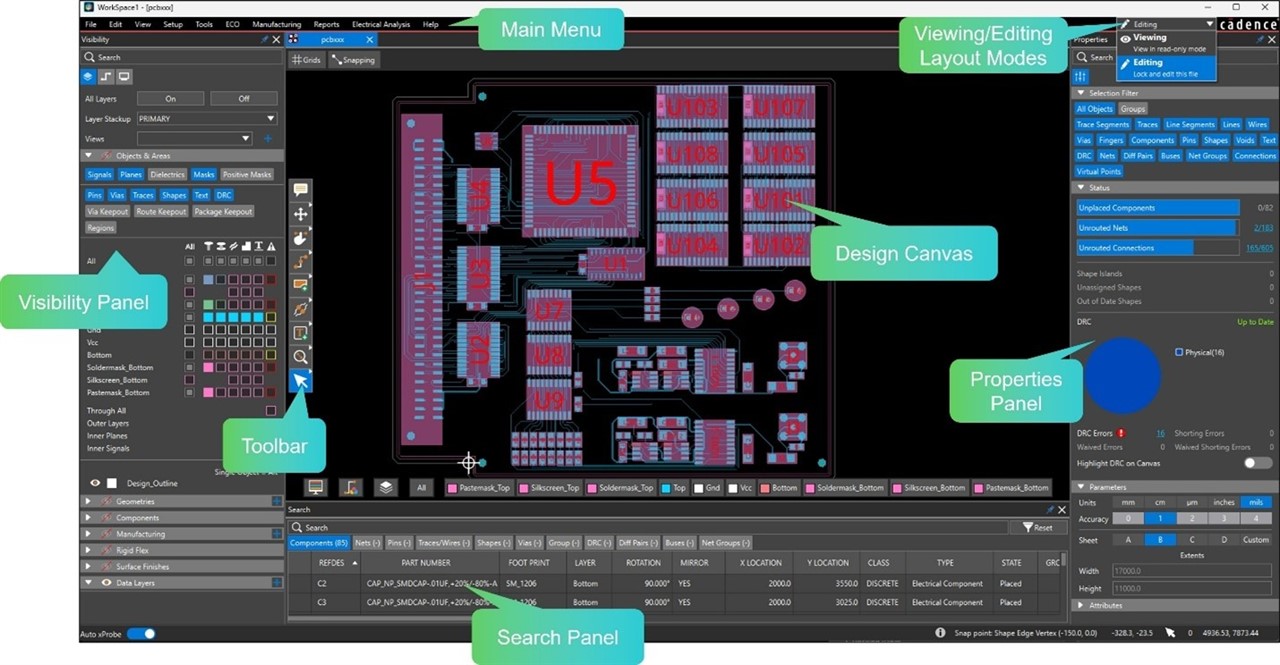

Modern PCB Layout Integration
System Capture is closely integrated with the layout editor, ensuring that logical data is accurately transferred to the physical board.
The integrated layout environment provides several key features and benefits that enhance designer productivity.
  • Visibility Panel: Provides centralized control over the display of specific layers, nets, and objects such as traces, vias, and keepout areas.
  • Properties Panel: Displays all attributes of a selected design object in real time, including names, location, electrical properties, and other parameters, and allows direct editing within the panel.
  • Constraint Panel: Enables creation, modification, and review electrical, physical, spacing, and same-net spacing rules without leaving the editor.
  • 3D Canvas: Enables 3D visualization of the layout to help identify potential mechanical overlaps between components and mechanical objects early in the design process.
  • Customizable Shortcut Keys: Define custom hotkeys to accelerate common design tasks and improve workflow efficiency.
  • Padstack Wizard and Template-Based Footprints: Supports quick and accurate creation of padstacks and footprints using guided wizards and standard templates, reducing errors and library creation time.
  • Seamless MCAD Integration: Ensures synchronization between electrical and mechanical designs to prevent late-stage conflicts, such as component placement conflicts with enclosures.
  • Cross-Probing: Supports bi-directional highlighting of a component or net between schematic and layout, enabling faster validation of component placement and critical routing..
  • Layout File Compatibility: Ensures seamless use of existing layout files (.brd) across both the traditional Allegro X PCB Editor and the new layout environment within System Capture.
  • Copy and Paste Layout: Enables copying and pasting of layout sections—including components and routed connections—within the same design or across different designs.
  • Advanced Routing (Assisted Mode): Provides intelligent routing guidance that avoids obstacles and maintains clearances while preserving manual control.
  • Easy Copper Plane Creation: Simplifies configuration of copper pours, voids, and thermal reliefs using intuitive panel controls without navigating complex dialogs.
  • Dynamic Documentation using LiveDoc: Enables the generation of fabrication and assembly drawings on a live canvas. LiveDoc automatically updates drill charts, stackup tables, and other documentation as the design changes.
  • One-Click Exports: Simplifies the generation of manufacturing outputs. including Gerber files, drill files, and assembly drawings, and reports, without repeatedly adjusting complex settings.

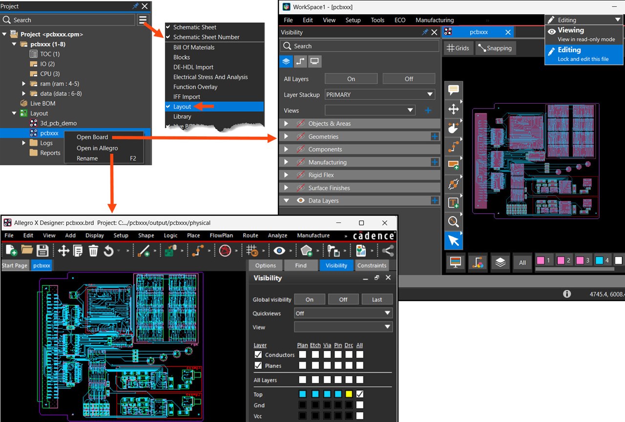

Accessing the Integrated Layout Editor
Accessing your board layout within System Capture is simple—you don't need to manually open a separate tool or export your design. Here's how to open the PCB layout directly in System Capture:
1. Enable the Layout View: In the Project explorer (left panel), do the following:
  • Click the Settings icon (three horizontal lines)
  • Choose Layout to add the layout folder to the project tree.
2. Open the Board File: Right-click on your board file (such as pcbxxx.brd) within the Layout folder.
3. Select a Mode:
  • Select Open Board to view the layout in a new tab within System Capture.
 Or
  • Select Open in Allegro or choose Tools – Launch PCB Editor to open the layout in the Allegro X PCB Editor application.
